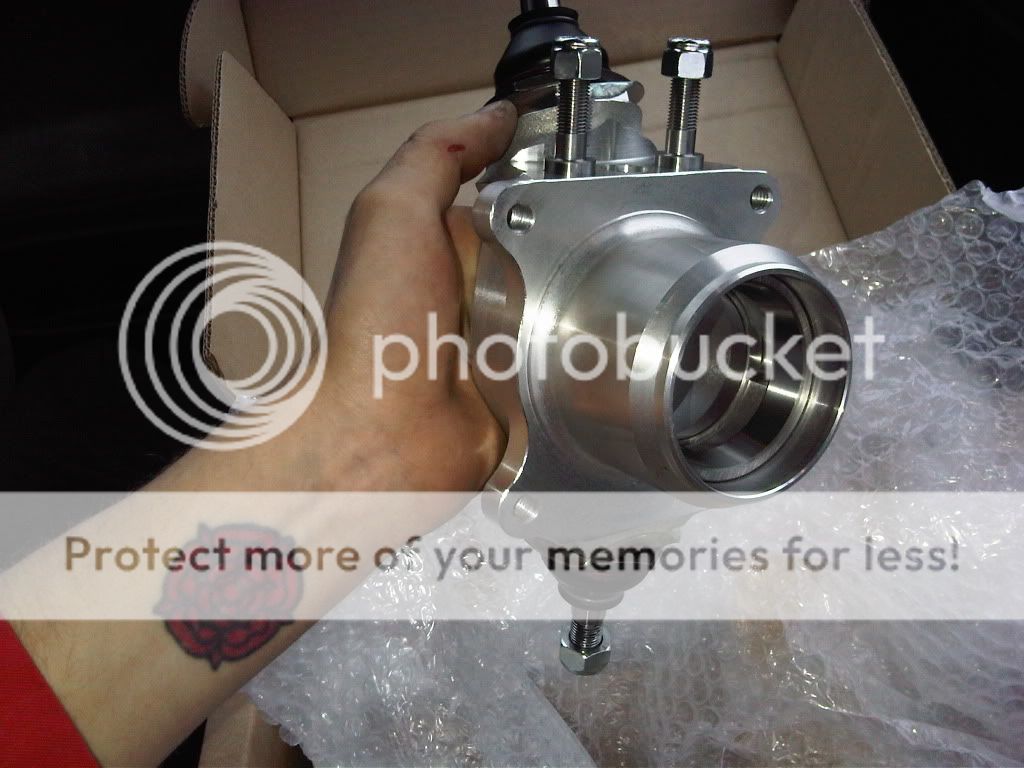

There are pictures on another forum of a set someone has just received.
I doubt he'll post them on here as he (chris-pilling) doesn't like us 'cos we upset him!!
graemec
940 Posts
Member #: 1424
Carnforth, Lancs
But I'll try ...8-)
Edited by graemec on 26th Feb, 2010.
Only one issue with them as far as I can see, they have taper roller bearings - Id want balls (bearings that is)
Paul
graemec
940 Posts
Member #: 1424
Carnforth, Lancs
And apparently there is something about making the distance between the bearings larger to remove the preload. Which make me think they will need constant checking. But maybe that it the 'flaw' they found in MiniSports?
It is from the Mk1 forum.
That would surely make more poreload?
http://www.serifwebresources.com/phpBB2/vi...&forumid=250646
graemec
940 Posts
Member #: 1424
Carnforth, Lancs
I guess it means all bearing load is dependant on the hub nut torque as the space will no longer keep the inner races at the set distance apart?
I can't see how this will be good for the bearings or indeed the hubs as surely it will force the outer races into the casting more (especially if over torqued).
However I am sure KAD will have good reason (if indeed it is actually the case).
