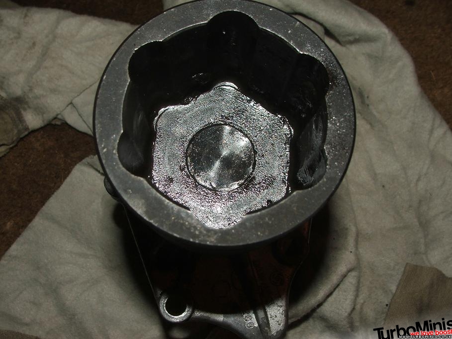

One of the offending joints. Off to the machine shop tomorrow to borrow the band saw *happy*
6966 Posts
colin, i doubt a band saw will touch these, if they are anyting like as hard as standard items.
i'd press it off,
support the cv on two angle irons at the joint with the cover and then press out through the plug in the bottom inside,
this little disk plug is only thin and will offer no resistance,
carl
Carl, there is no plug in the bottom, That was the first thing I checked, these have been machined 'blind' that is the problem with trying to press it out, you would have to drill/ mill a hole in the middle of the pot to get to the end of the shaft.
Its not going on the band saw *happy* Its getting Plasma cut *hehe!*
Its whith the machine shop and they will do what it takes lol.
6966 Posts
colin, that plug must have been put in post splining, the broach would have to pass well past the bottom and into the cv housing,
carl
Just had a closer look after cleaning one up and yes you are right, there is a plug in there.

Carl's Right Colin, what are you thinking that is a plug and is obviously softer and could be easily pressed trough duuhhhh
EDIT: Dont mind Colin's Quote he obviously made it up to make him self look better :$
Edited by PaulH on 26th Feb, 2010.
On 17th Feb, 2009 Rob H said:
On 26th Feb, 2010 PaulH said:
There is no Plug Carl. as Colin said there Machined blind.
*hehe!* no mate, there is a plug in there, its solid plug rather than just a cap of thin metal. Looks like its softer than the joint too.
Perhaps there are 'blind' machined joints, but these are not those.
6966 Posts
they would never be blind broached, hasve you seen the length of a machine broach,
I've seen one for cutting synchro hubs - that was around 30ft long...

I'm relieved that I wasn't cracking up when I said there was a plug/cap in there.
6966 Posts
The omly eay you would get a spline in the on a blind hole would be to spark it out,
and knowing china may very well have done so,lol
Been on the beers again Carl? *hehe!*
Pot joint now removed!
It was as simple as Carl suggested, smart arse *tongue* *hehe!*
Drill a big hole in the plug then wedge the joint in a BIG vice mounted to a 1 ton steel bench and with a suitable drift and a really big hammer twat the end of the shaft with a hard fast blow *happy*

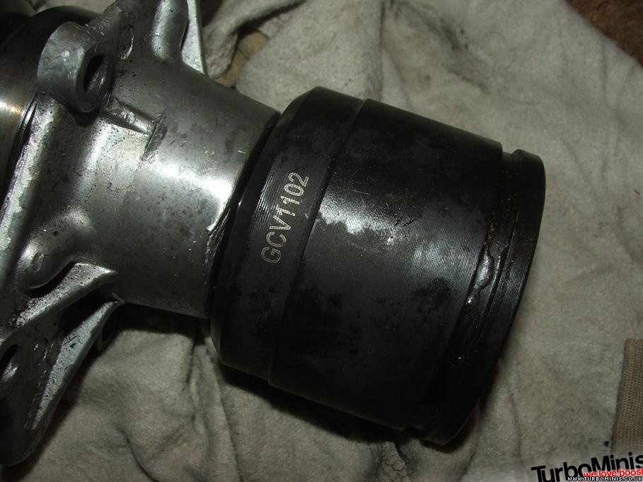

The clip broke and has gouges where it was jammed on the splines
Checked the balance of the flywheel while I was there, before they replaced the ring gear. The ring gear run out was a joke! and balance was out un surprisingly. I'll be glad when I see the back of this engine *Shooting*
Being trying to fit the drive shafts to my car. Drivers side went pretty much straight on, but the passenger side will not go on with any amount of brute force. Tried the passenger side on an old diff out of a box with no ring in the groove. Wouldn't go on at all and had to give the diff cage a good bashing to get it off again, even thought it wasn't on more than 3-4mm. Looks to me like the inside of the splined bit is too tight or the splines are the wrong shape/size.
Now off to look for two new inner pot joints...

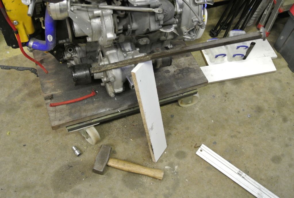

If your engine is out of the car, maybe you can do what I had to with this engine , they where really stubborn specially the one I have the crow bar on in the photo, you need to keep turning the pot joint every 2 to 3 blows with the lump hammer, this allows the circlip to keep dropping in its groove until you get lucky, ignore the piece of wood I have propped the long bar with its just to take the photo, this worked for me after a bit of persistence.. Alan

Pulled off the other joint which came of as expected. Had a very crude measure of the two joints.
From the bottom of the valley of two opposing splines. The good one is 22.08mm and the bad one is 22.02mm. So the problem is obvious.
Undecided whether to replace them both or just the one that doesn't fit. Budgets are extremely tight...

Have you tried the one you say fits, on both sides?..
Edited by nala56 on 2nd Oct, 2012.
Main Build
Upgrade to Turbo
No, but I've had some used pot joint cups on both to seal it while I got the oil pressure checked.
nala56
825 Posts
Member #: 9661
Sheffield South Yorkshire GB.
So just change the bad one, I would..
