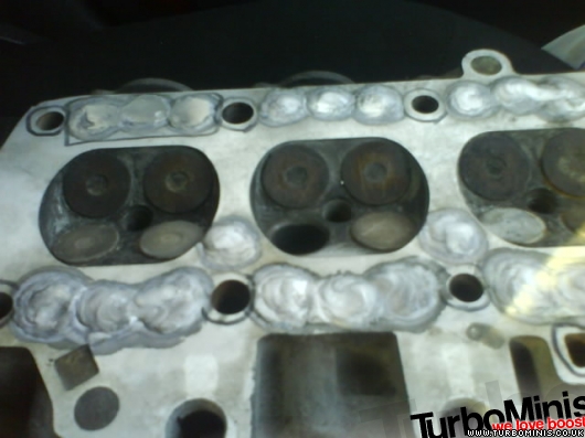

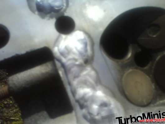

Joe - I put about 30psi on it and spayed some water over the face and there were about 5 places where there were tiny bubbles, The hole aren't even visable though. The guy drilled each weld out with a 15mm drill and rewelded.
I think im sorted for a spare now aswell! :)
Colin - You should of seen the look on the guys face when I turned up with it all welded up, and told him "there is no sign of a crack". He looked suprised and kind of releaved and the same time! *hehe!*
Not sure about the piston...you can ask! lol
Edited by matty on 10th Apr, 2010.
Here's the new welds...look much better!

Finnally got round to pressure testing mine today, out of the 19 welded up holes, who wants to guess how many didn't leak?
one?
all of them
advantage998
458 Posts
Member #: 1840
Kings Lynn, Norfolk
Yup all but one leaked, wasnt holding out much hope as the welds looked worse than matty's, gonna face it off and mill out the welds a couple of mill and try to get a different welder to have a go this time.
Its a pain in the arse isn't it! How bad are the leaks? Are they just pin holes?
did you use the same welder as Matty?
