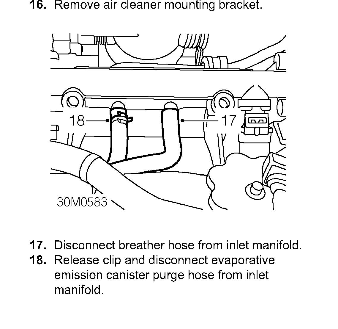

Not sure if someone replied on the inlet barb connections.
I don't remember how they get routed, but I seem to remember the hoses going to pipes that then go to the breather and the purge valve.
Carl S
1927 Posts
Member #: 1761
Stalker
Thanks tmsmini, that's just what I was looking for.
I'm assuming I can just block the both of them off without issue. It has got me wondering what this 'evaporative emission canister purge hose' connection functions as however?
