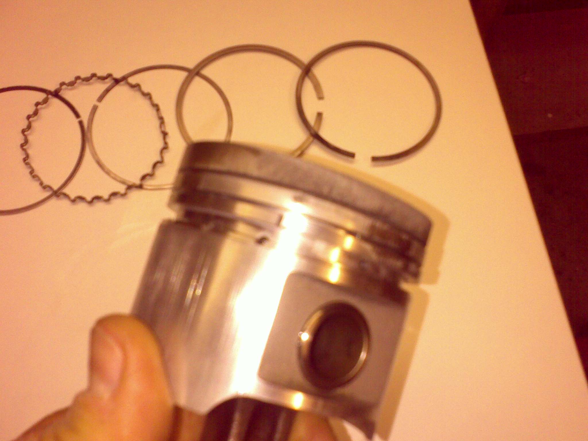

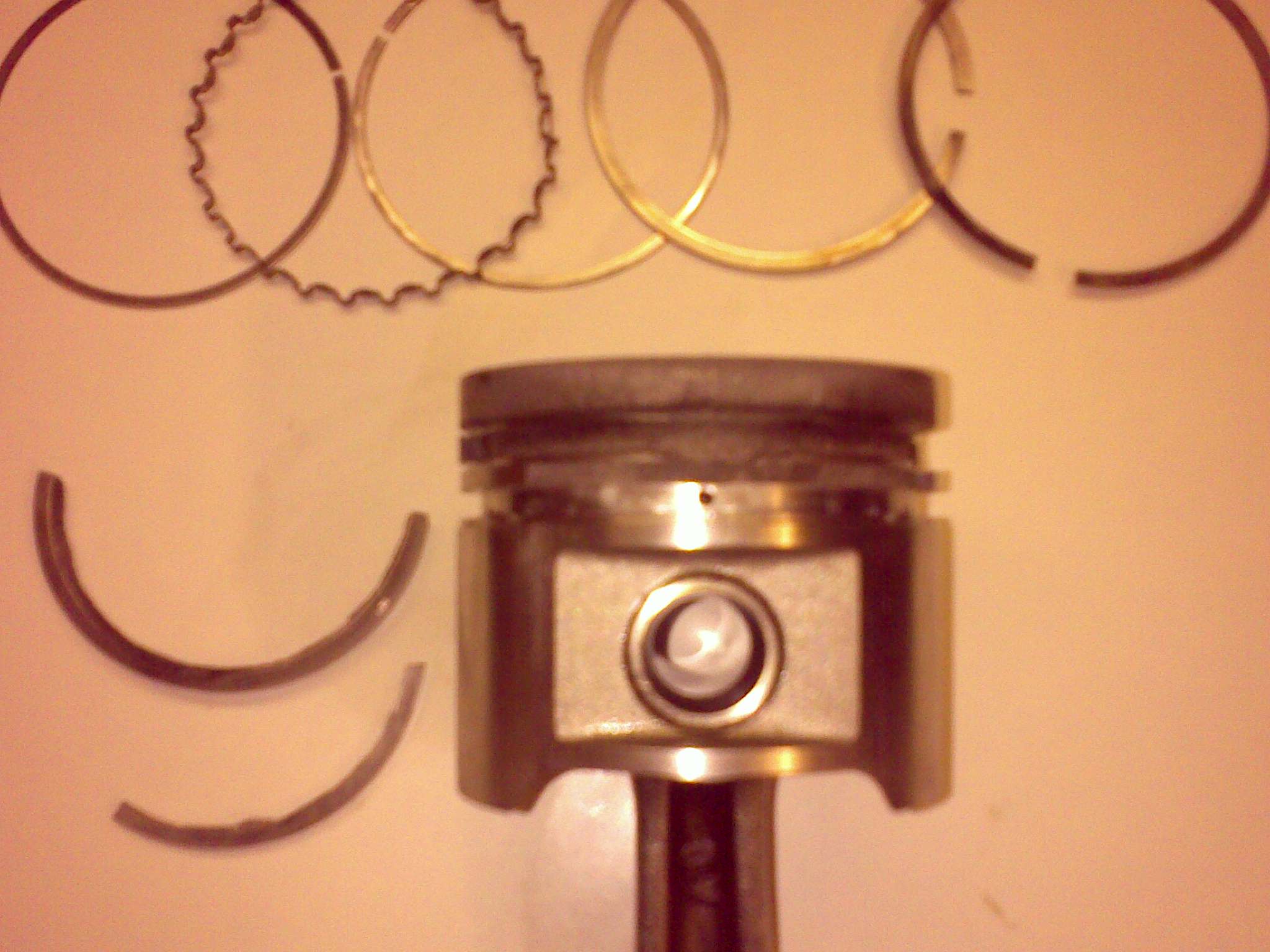

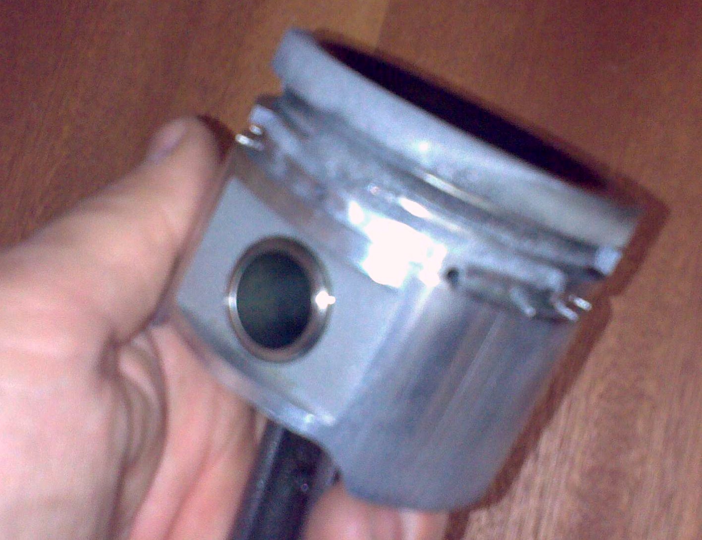

Hi guys.
Finally got the van motor stripped and am now on my way to rebuilding.
Have attached a few blurry shots taken late last night - sorry about the quality but they're from my phone.
However, it's pretty clear that No 4 piston has suffered detonation damage from the edge of the bowl (at the inlet valve rather than the exhaust) down past the top ring into the middle piston ring groove.
Additionally, what's taken me by surprise is that two considerable pieces of material have completely broken off between the top ring and the oil control ring. The one at the top is about 3 inches long, the other below it is about 2 inches long.
The initial things I spotted were two cracks between the ring grooves, with the material raised so that you could feel it with your fingernail but after giving the material a slight tug, both pieces just came off in my hand so there was some serious circumferential cracking going on under these segments of material and they were only held on by about 6 sqmm.
Luckily, the pieces had not detatched with the engine running otherwise there would have been bore damage, which there isn't.
Popped all other pistons out whilst I was at it. All are as new with bores to suit so they'll go back in. I'll also put a light hone on No4 in prep for a new single +.20 cast Omega.
Anyone got a spare piston lying around ?

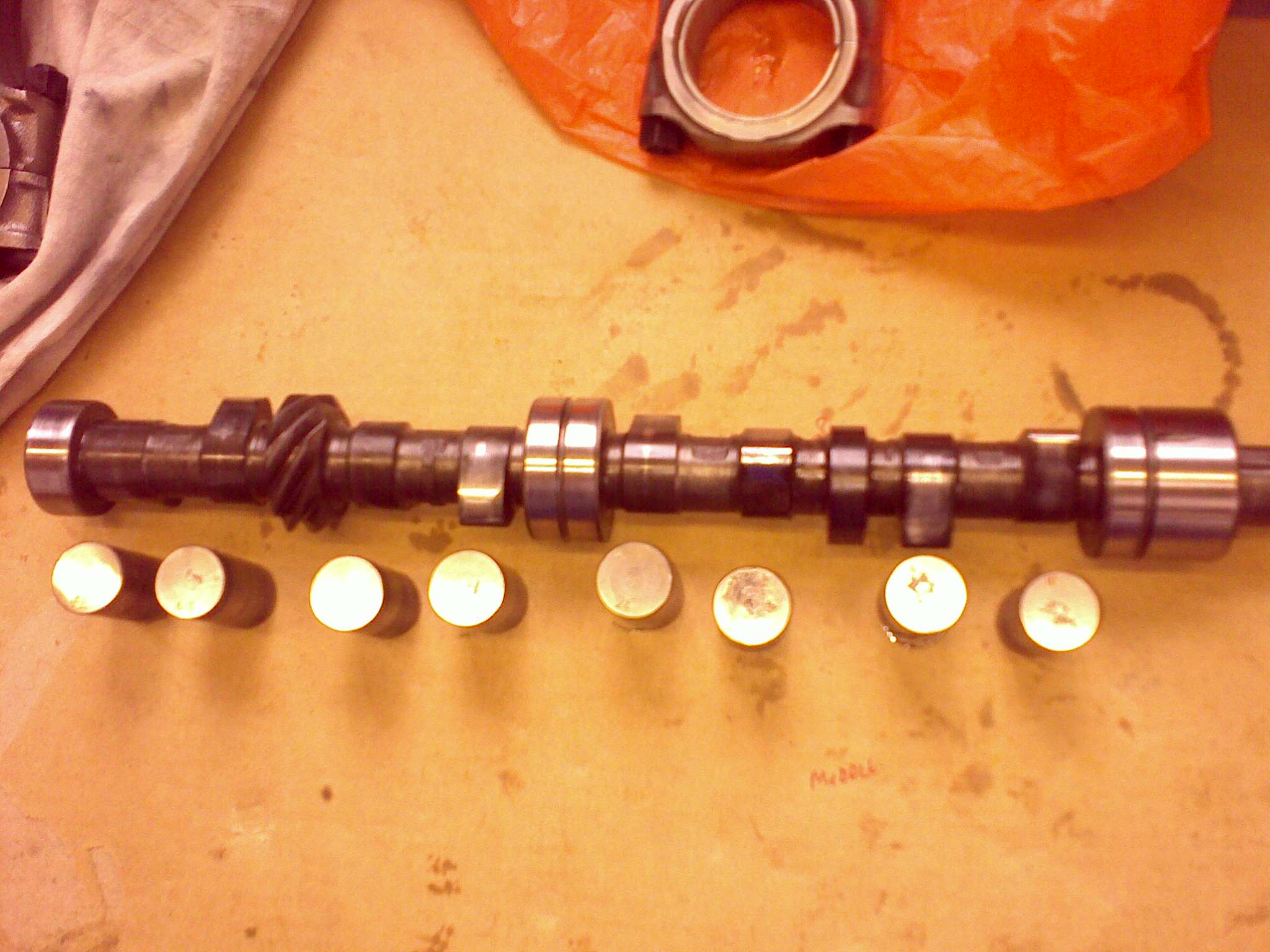

b. Despite only about 2500 miles usage on VR1, the lobes on the Avonbar Phase 2 cam and the cam followers can only best be described as 'past it' and I'm gonna need to replace them. Pitting is severe on No2 inlet follower and the cam lobe has a pronounced flat on it. No idea why.
I have the chance of selecting another cam or a replacement AP2. Any suggestions ?

with a flush decked piston . on a 1293,richard .
bad luck on the cam ,how many miles had the cam done ,and what pressure springs are you using ,oh ,and what ratio rockers ?
