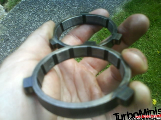

Is it ok to mix these two types of bulk rings? I want to use the nearer one?

I just rebuilt a box and both types of bulk ring were fitted on stripdown. The genuine rings I bought to rebuild the box with were the type with six grooves. Maybe the other type in your picture are an earlier type?
Cool, I'll use that one then.
