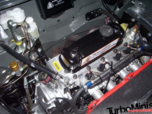

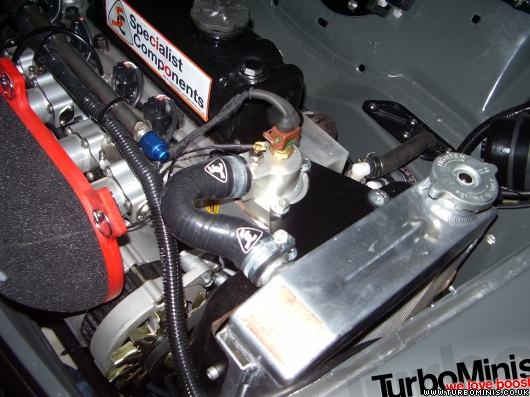

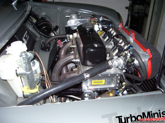

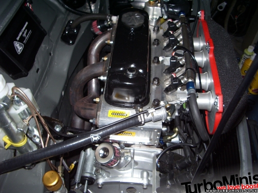

some eng pics
Diogo - I know where you are coming from - I just wanted to keep it this side of the racer look!
[img]http://www.turbominis.co.uk/uploads/i/wh530-oe1-at1/johnk-2086.JPG[/img[
[img]http://www.turbominis.co.uk/uploads/i/wh530-oe1-at1/johnk-2089.JPG[img]

Is it an LCB or a Freeflow ?

the exh is a big bore lcb - just up on dia's from our "normal" lcb but worth it for a real 135hp/8000rpm motor. There may be more in the engine with a manifold with longer primaries for cyl's 1+4, if I muster some enthusiasm I may make one to try.

looks so sexy and very naked down the back of the engine :)

Wow, one could eat in that engine bay ... It's mentaly clean !
