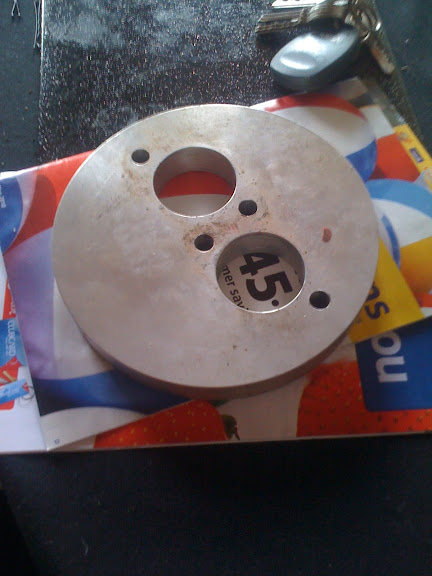

I have a spacer that ive looking to sell, you may have to mod it, ill pop some pics up later.
