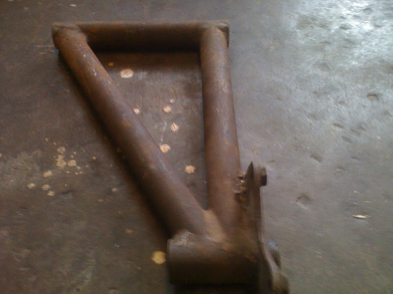

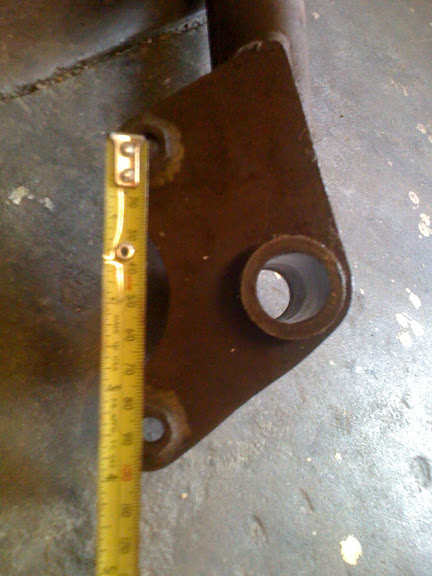

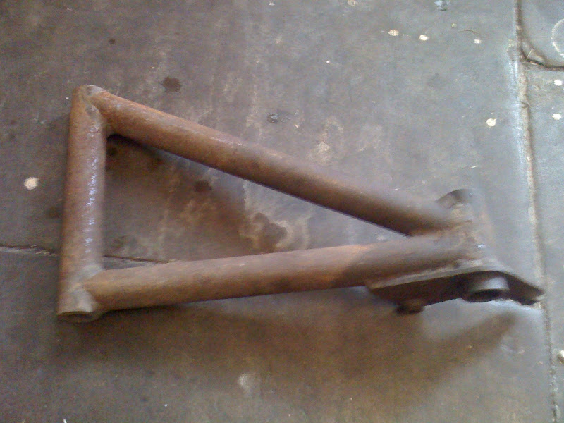

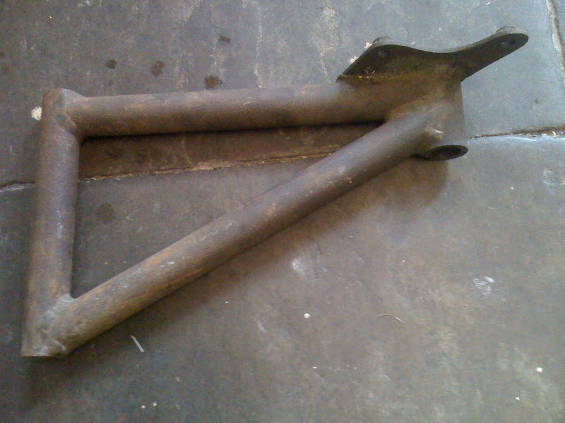

I thought this too however they arrived today and look and feel pretty substantial. Ill get some decent pics tomorrow. Mike
On 10th Jun, 2010 paul wiginton said:
I saw those trailing arms and I dont believe theyre strong enough tbh

Ard you gonig to show us these arms mike .
carl
yes but i keep forgetting to take a pic! Ill get one up tonight! I promise! *tired*

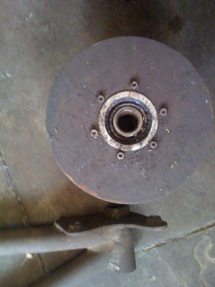

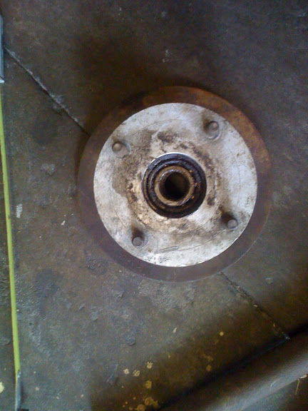

Right as promised:
Piccies
