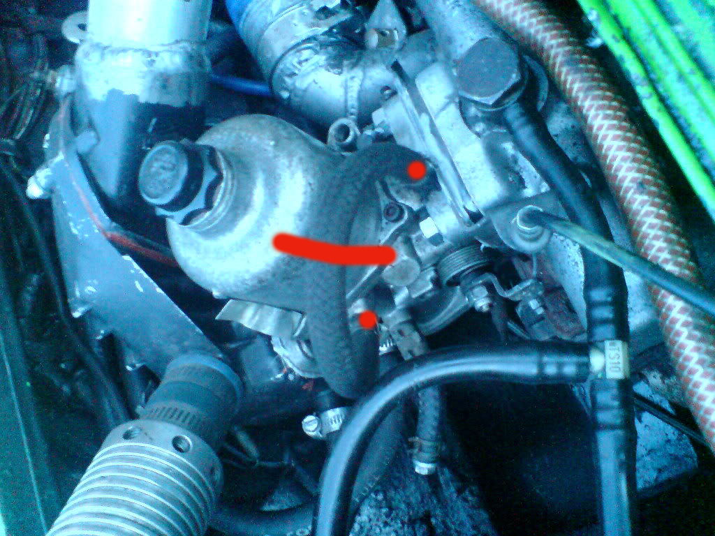

the jet is held by a strip that bends depending on fuel temp this affecs how much fuel the engine gets there are threads about its affects if you search, some people found they need to remove it and replace with steel to stop the fuel changging with temurature
just seen the pics (for the first time)
i would do this i had to do it to my n/a remove and block yhe part throttle leanoff

Thanks ill try blockin the part lean off pipe and see if that helpd.
