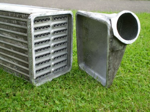

Just a pic of the inside of my intercooler.... I think it was off a rover!
They look identical to the 14 year old Pace cores I removed.
They certainly dont look restrictive....but cooling wouldnt be very good either.
Really a core needs to be specced for the usage. In terms of size available, airflow required and then enough capacity to remove the heat.
