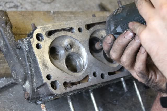

this then meant i could take off the head and measure the piston dishes ,the head gasket was 1mm bore 77.6mm ,so with all the volumes ,the cr worked out to be 10.9:1 .... this is v bad !!
so after measuring all the heads i have and so on , i relized that the new head gasket i got today ,was 1.7 mm thick ,this brought thjings down to 9.9:1...still not brilliant , i was hoping for what the books say and 9.4:1..i assume that the wrong gasket was fitted before ..
so looks like tomorrow im getting out the animal bosch porting grinder ,and opening up the chambers ...what a pain , i really like the chamber shape as it is!

phew ! well now down to 9.4:1 ,3.5cc out of the head .....noice.
ok ok , ill admit it ,there may have been a bit of porting as well :)
all valves ground in after having to recut the inlets ,all a bit out of round towards the edge of the chamber ..
