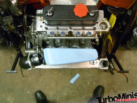

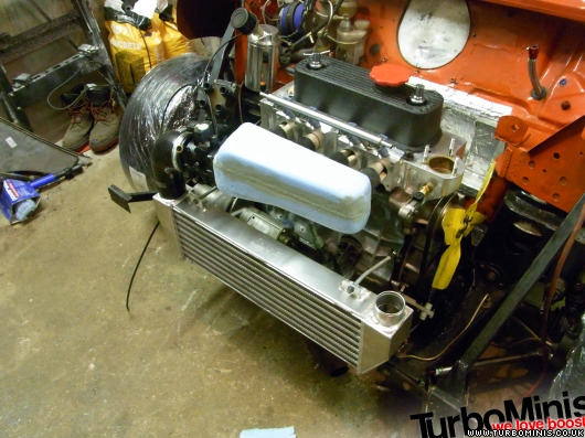

Here is the mould for the plenum

Are you working in your garage in suit trousers and black shoes?
Yes. Last evening I went in to the garage planning to tinker for 1/2 and hour. 2 1/2 hours later I emerged with a mould for the plenum. I usually get changed.

Looks good. What's going of with the trumpet on no 2?
Don't worry about the trumpets they are just stuffed in with bog rolls to help me get the shape.
When done the mouth of each trumpet will be inside the plenum. throat length will be around 200mm.
