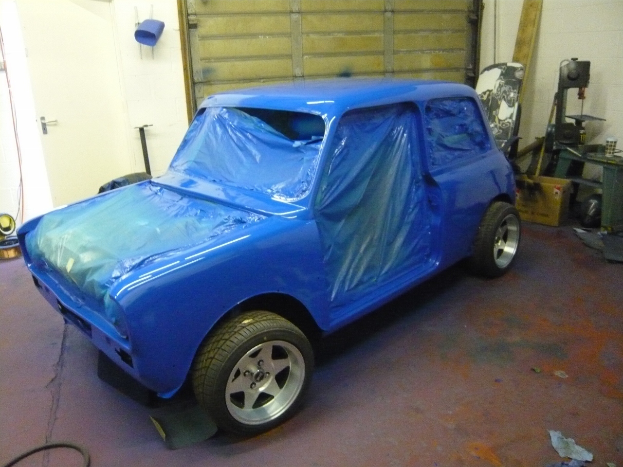

Not sure if I like the colour, but same lathe/mill as mine in the background.
I wish I had the matching pillar drill too.......

It's quite a good drill, better if I ever bolt it down...and a bargain compared to the lathe!
The colour was the result of being forced to finally make my mind up. Too many green/orange/red/yellow minis... bluey purple - it's the new black.

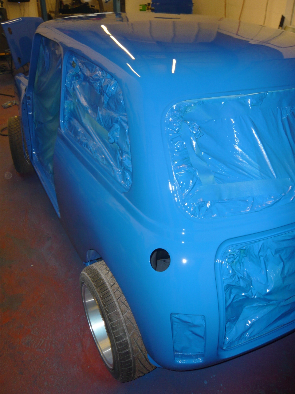

Never one to not listen to the multitude of people who said my car was a shit colour within a day of me painting it I've changed it!
I must admit I like this better too.. (grumble, mutter, expense, more bloody work)

nice colour, i liked the previous one too. what shade of blue is that? ive always fancied toyota light blue mica if i can ever afford a decent paint job.

The purple was night blue (RAL5022), this blue is a HMG 2K SC601 colour called Ariston Blu. It's quite cheap (about £20/l) but covers as well as the much more expensive stuff from dupont etc.
