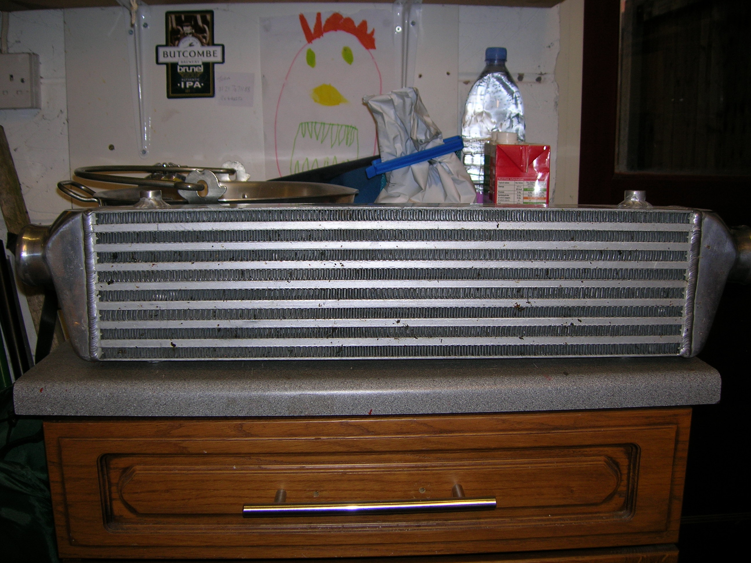

Similar in appearance to the Forge type 104 ie straight ends,540x140x65.Mounted across the car in front of the radiator.

See pic

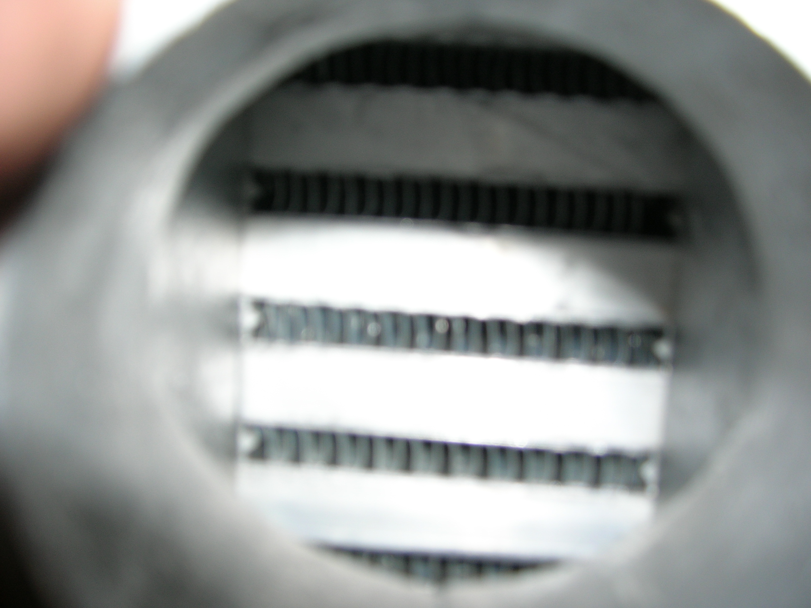

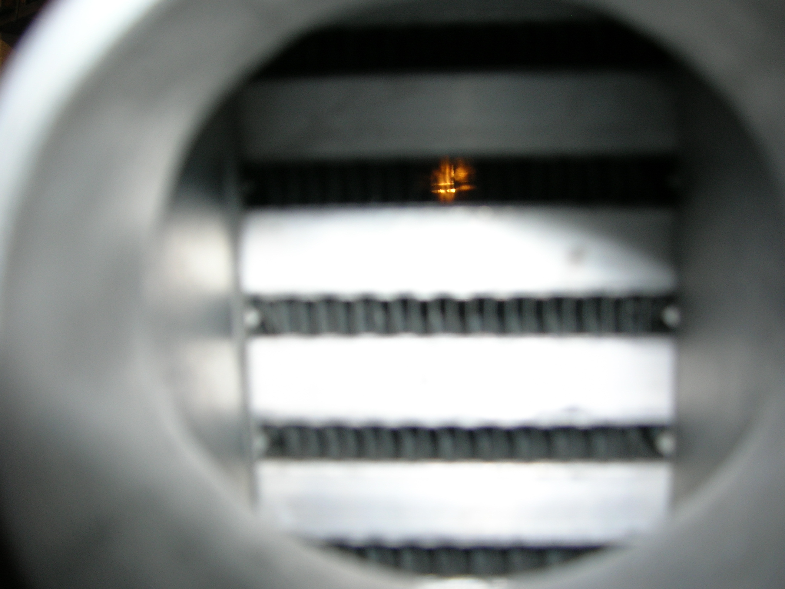

An internal pic would be most useful.

Best I could do.On the 3rd pic I shone a light from the other end.
