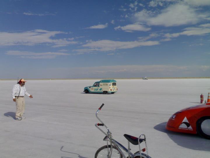

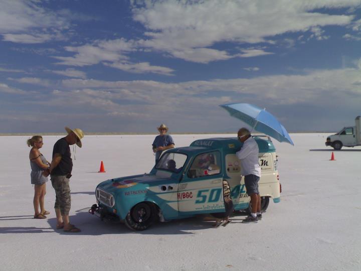

A freind of of mine was at bonoville speed week this year, he took these photo's 8-)
