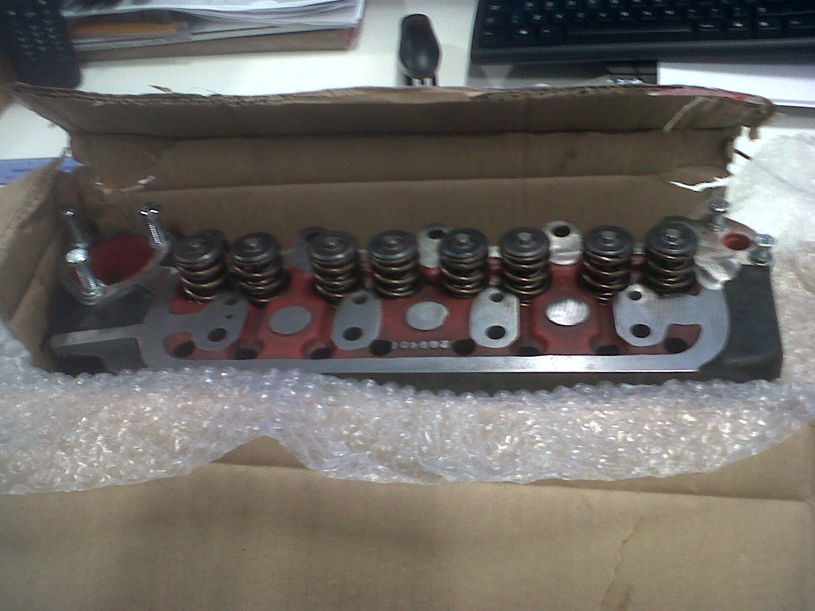

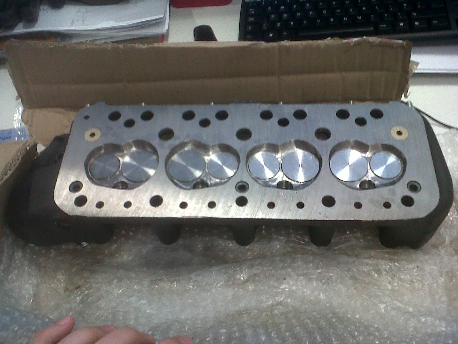

With the winter continuing decided to make a start and fit the MJ kit that i have had sitting around for a while, fix the oil leak on the timing cover and have BENROSS build a new head.

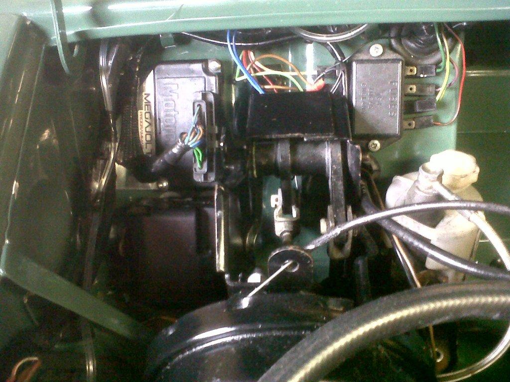

Mega Jolt installation is going to plan and managed to convert from TPS to MAP with no real issues apart from fitting the MAP sensor upside down (school boy error). had Tom make the pulley and bracket so should be an easy fitment.
just received referbished cylinder head from BENROSS and the workmanship is outstanding.
thanks again steve

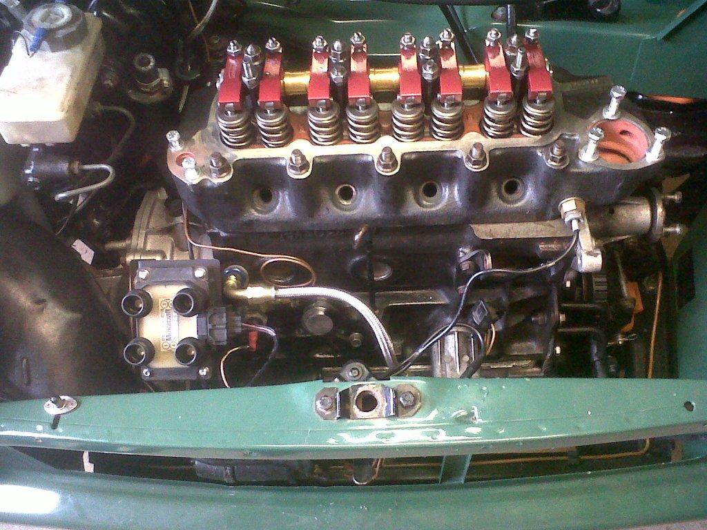

a little more work done over the weekend on the mini, managed to get most of the MJ insatlled and engine rebuilt *smiley*
had a few issues which is nothing usual when working on the mini *surprised* still awaiting some more exhaust wrap to allow the maniflow stage 2 manifold to be refitted, then finish all the other ancilleries and see if its starts.

well its ALIVE *happy* and running on MJ. *Clapping*
had a light issue with VR sensor as was unsure of which way was the correct way to connect it and guess what i got it wrong :( , simple fix though as hadnt soldered wires :roll:
checked crack sensor and spot on 10 degrees (cheers tom) the question that is running round in my head is "if edis4 is running waste spark why does my dinosaur timing light read 10 degrees with MJ disconnected and not 20" as its firing on the exhaust too. *Idea*
dropped in a temp map until i get it rolling road'd *happy* (cheers smiffy)
need to get it back on its wheels now and refit dash as it all works, got some pictures and video so will post later.
