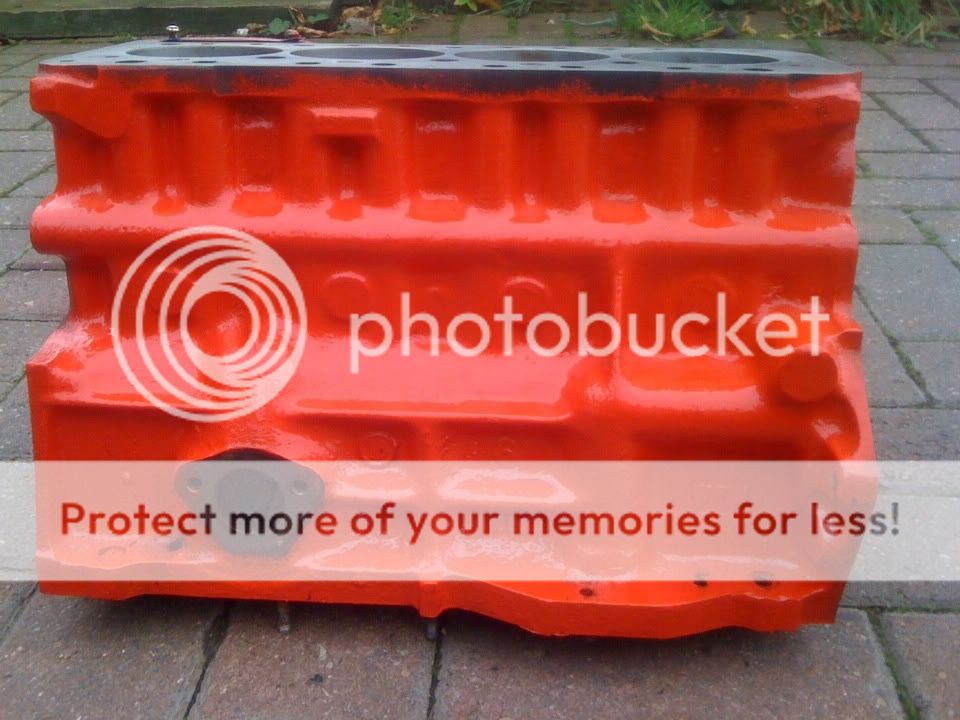

Hey guys! Last question *smiley*
Here is the back of my block im guessing the bung is the bit that sticks out on the right? Just want to confirm please *smiley*
yeah, on the early blocks it was tapped with a screw in bung,
you can make it out on this one.
Craigie-B
1492 Posts
Member #: 9468
Wootton Bassett
Excellent thank you *smiley*
