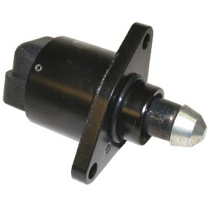

Looking at the Pug one the 'nob' bit does the sealing, right?
So I need a boss made with a seat for sealing. I'm thincking of maube attaching it straight to the inlet manifold.
Why has your's got two pipes on it Paul? is is so you bleed air equally to each side?
It's inlet and outlet. The 'nob bit sits above a seat. The 'nob moves in and out to control air drawn into the engine by the inlet manifold vacuum.
ok. So one pipe goes to the engine side of the butterfly. ther other? surely that just vents to air? unless you put it back to a filtered part.
I don't think is is a wet manifold issue, all it knows is that it is a certain AFR and it needs to reach a target. It wasn't the flat out bit that was a problem though. It was the cruise and light throttle. Before I used it I had a car that drove nicely but was a little rich, afterwards I had an undrivable car which was still richer in really odd places.
Yes, back to post-filter or just put a small filter on the inlet.

On the mpi manifold the other end connects onto the TB upstream so it gets filtered air. Could use a filter on the valve for NA but I guess it might boost out the inlet on turbo applications if it were open at all so would need similar plumbing.
Cheers. I'll give it a go then.
You will need the MS2 daughterboard to drive the stepper type IACV.
Edited by Paul S on 15th Nov, 2011.
With the SC throttle body could you setup some sort of servo or stepper to kick the butterfly open automatically as opposed to an IACV? Or would this not give a good idle?
oh, didn't realise that.
Right, I'll get a PWM one then, easier install, just they look a bit price. I hope my MS1 ia suitably modified to drive one. Not sure what the mod is.
The Rover SPi and the early Rover T series engines use this method, also known as a throttle kicker, as it operates dirrectly onto the throttle, rather than bypassing it.
I remember the kicker on my SPi. Used to idle ok. So would this principle work?
The MS has a Fidle output that should drive a fast idle solenoid or kicker.
If you wish to use a PWM valve, you may need to add a TIP122. It's all in the MS1/Extra manuals.
EDIT: You may already be using the fidle output to drive something else though.
Usually to replace the small transistor that just switches a relay with a larger one to handle the current of a PWM valve.
