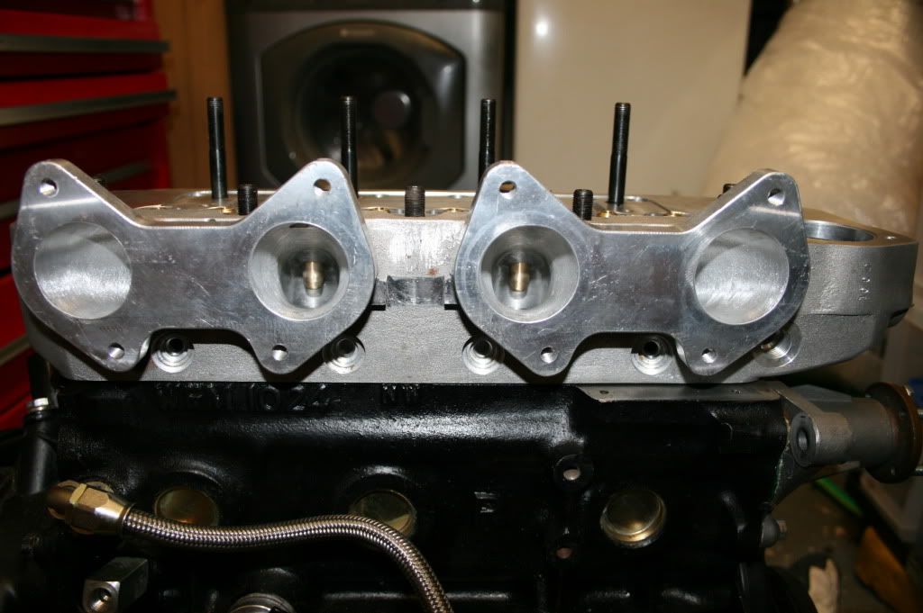

Jean, excuss my ignorance, maybe not, but certainly more than a wet setup, considering need for cam sensor, dual widebands, sampling tubes etc. to do the job properly. As ill need a new head anyway, the SC 7 port looks quite tempting. I plan to make my own plenuem & use MS3 ecu.
jbelanger
1267 Posts
Member #: 831
Montreal, Canada
It's going to be difficult to package long inlet runners with a 7 port head. And if economy is the priority, that would be an important part.

What kind of length are we talking? I could move the plenum under the snatch panel on the clubman. I have about 90mm for the runners if I dont cut the front. ie Head face to plenum. So 150mm in total.

If you are going to make the plenum anyway isn't it worth considering the 5 port with port injection? The engine could be pretty standard for the performance you are after.
My main concern is making the plenum / inlet manifold, the cam sensor and sampling tubes should be reasonably straight forward.
I would put the extra cost of the wideband, cam sensor and sample chambers at around £200. That's £150 for the 2nd wideband, £25 for a cam sensor in a dizzy body and £25 for tubes and fittings for the sample chambers. If you have your own fabrication facilities, then that should be it.

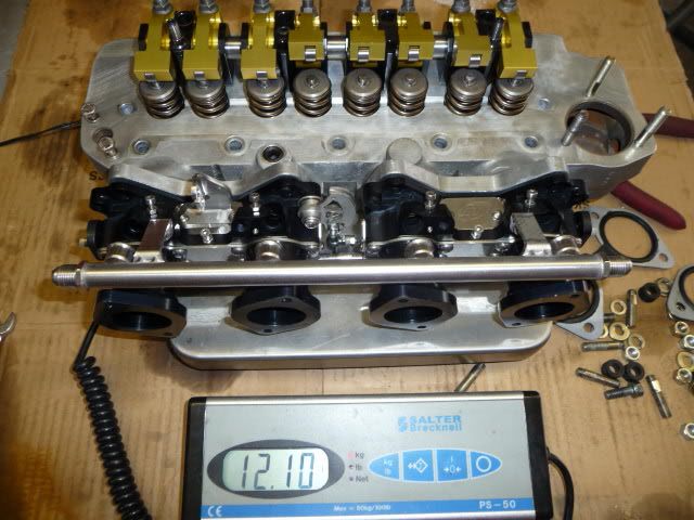

Currently 36x29 valves, smoothed ports, throat area opened up, with SW10 cam, 10.5-1 CR, 1.3 Rockers. It made 101 bhp.
Compared to same engine with Vmax Scart stage 4 36x31 head @ 10-6-1CR that made 84bhp.
I found the webbers very smelly, the engine ran more lumpy and was off cam until 3.5k, instead of 2.5k. So the plan was to use some AT Throttle bodies to sort out the bottom end and hopefully fine tune the top end power. But now thinking of swapping the turbo on the clubman and going all out with the 7 Port n/a on my lightweight mini for track days and class B. Still only thoughts

So how are going the pull the injections back from the head face? I thought about using the Webcon 7 port head with the AT TB's in the same way but decided against it in favour of a single throttle body. Up until recently I was planning the 7 Port on the trackday turbo, but I think ive decided n/a would provide a more predictable / reliable trackday engine and weigh 17kg less helping me to below 550kg. I dont honestly think any more boost after 10psi will do you any favours on the track anyway.
