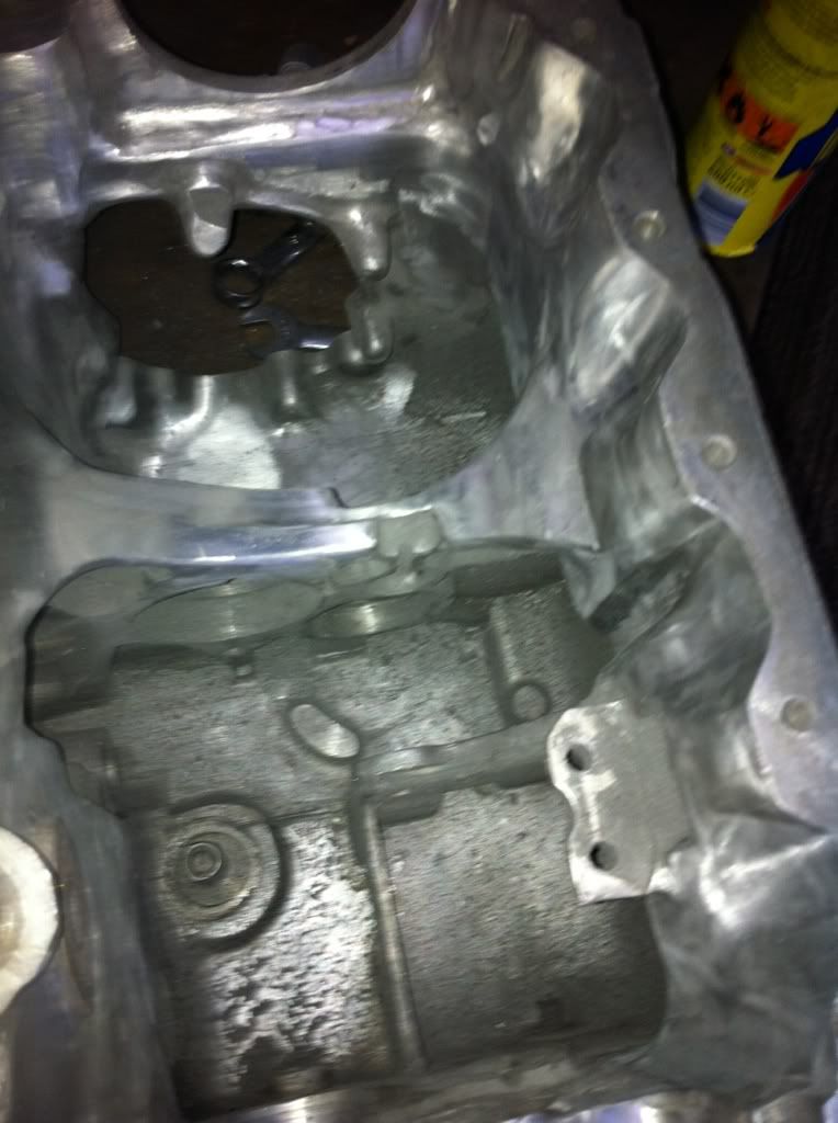

Well I have been on with this. I just have a bit of fina cleaning upto do. Rolocs were a winner, don't know why I didn't buy these years ago!
Not the best picture but gives a idea.
Ron
Nice work, how long did it take to clean up?
looks good mate, must have taken a while.

It's not finished but probably spent a good day on it so far. I would have finished it but couldn't get any more flap wheels over the weekend!

gosh*surprised* ,dont they vibrate a bit ....what rpm do you use ron ?

Do these Roloc things go into a die grinder or what ?
9.85 @ 145mph
202mph standing mile
Die grinder or an ordinary drill
