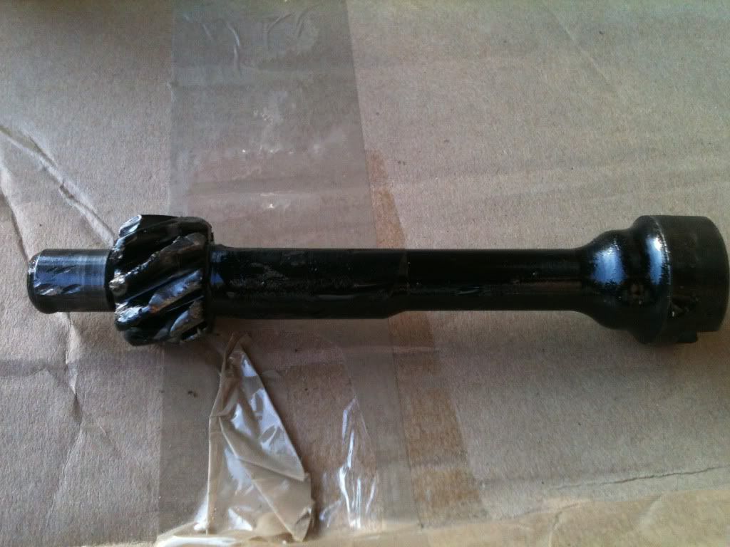

I flushed mine out 3 times with new oil and filter but still wasn't happy so came out for a rebuild, most of it was gone but when I turned the gears it did not feel very smooth.

Found the drive in my garage yesterday, not as bad as bennyy's, but still, lesson learnt...

I would give your engine a couple of oil changes to get rid of the worst of the swarf.

It'll be getting a proper one in two weeks time when i take it apart to change crank main bearings, fit x pin diff and high flow oil pump.
I'll make sure I get all the bits out then
