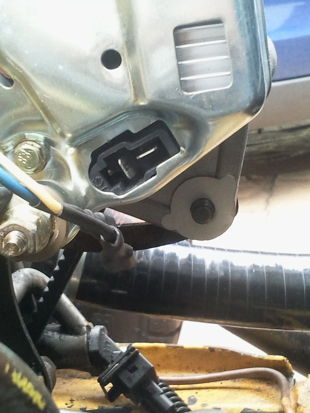

I'm sorting out the connectors I've bought by PM at the moment.
I need to confirm that they fit first however, then I'll post up what I've found and offer the connectors to the relevant people.

wich connector have you used brett and were from? or have you used spade connectors?
Done now needs redoing lol
I used spades mate squished them a little so there tight

i got a connector from autospark after reading another thread and it was a close fit but not right

The connectors I purchased for the alternator have now turned up, and do indeed fit correctly!
I shall be sending out PM's in a bit to those who have already got in touch with me about buying my spare 4 connectors.

I just bought connectors for my lightweight alternator (bought in the same alternator batch as Bretts on ebay), and I can tell you that the connectors that Brise sell are the correct plugs for the 2 pin alternators. Bought mine last week and is absolutely perfect.

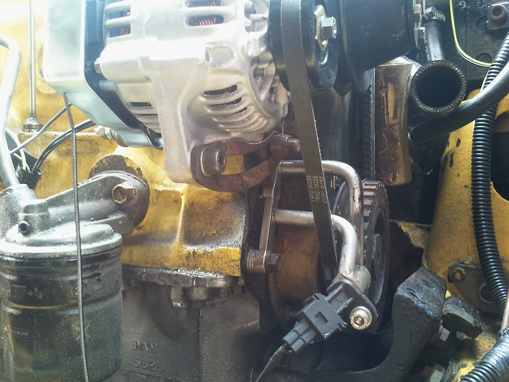

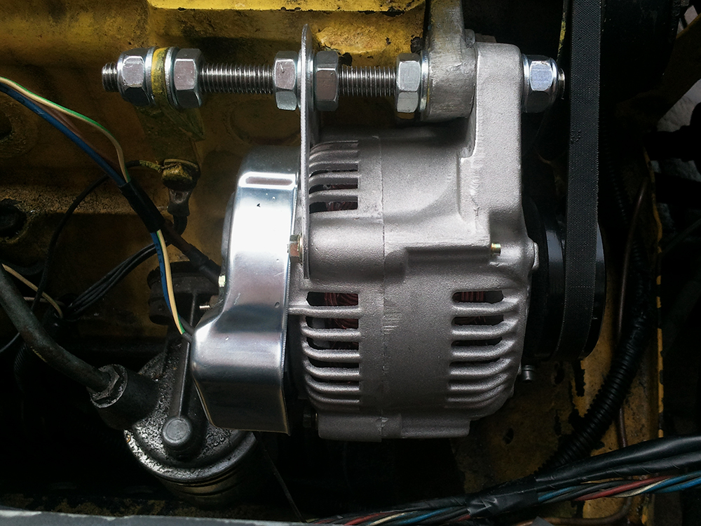

Brett I was looking for this post as I spotted you had ground your bracket down so the pulleys line up. Did you just do it with a grinder? I was going to but was worried it might not end up square so the belts wonky!
On 15th May, 2012 Brett said:
Just fitting it now i ran a tap through the water pump this should stop the bolt coming out again lol
On 15th May, 2012 theoneeyedlizard said:
I like what you've done there Brett. I'll probably be pinching that idea.
For a long bolt, a head stud fits nicely.
yeah hand grinder and eye balled it ( technical term round here )
imo it would be quite hard to get it too wonky as long as it looks straight
and tbh its 10x times better than the alternator that was on there ( factory one) that was out of line and eventually threw a bolt with the alternator shortly after
I've fitted mine in the same way. I checked for flatness using the verniers as even a bit of a wonky line on it made the pulley quite far out of line on my engine.
It was loads f fun filing 5mm of it manually...
