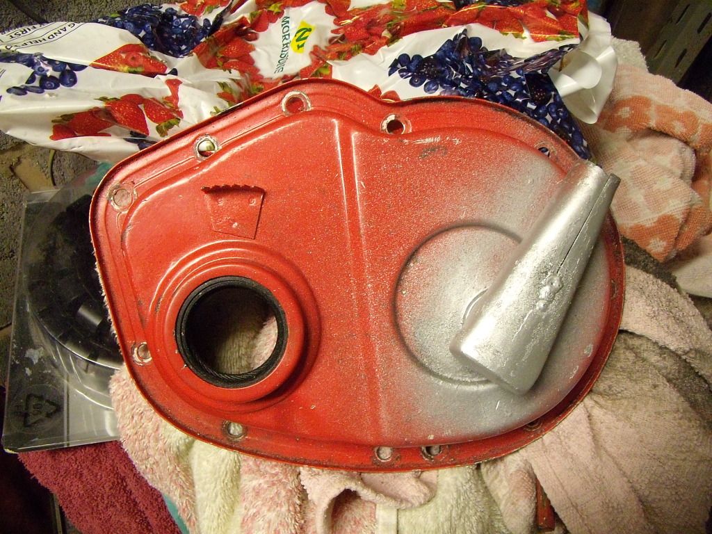

Benny - Have you tried welding it, with the cover bolted to a block? That should help stop it distorting.

No I hsvnt, that's sort of my plan, I can get some 2.5mm sheet steel, I'm thinking of drilling it out and bolting the cover with nuts and bolts, I think nsla56 approach is the best, don't actually weld to the cover

Here's an other idea that i started some time ago, did it slightly different as you can see, cut top and bottom off filter barrel, split it down the front, folded it together welded a new bottom in and formed the top to about 17mm, still to be finished later, hope this helps..

Got a linisher if you would like me to take any wrap out of the rocker cover and if there are any pin holes in the welding lets weld them up
