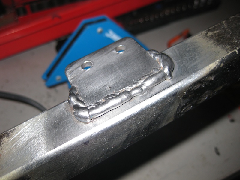

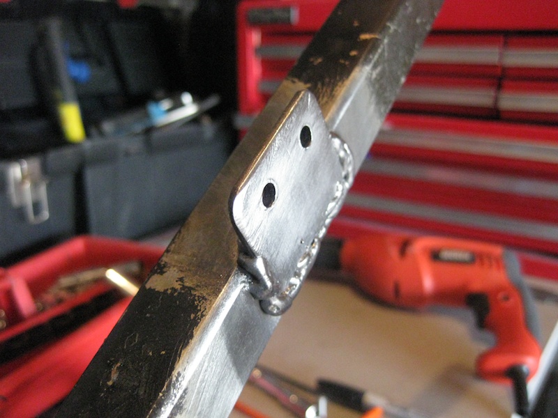

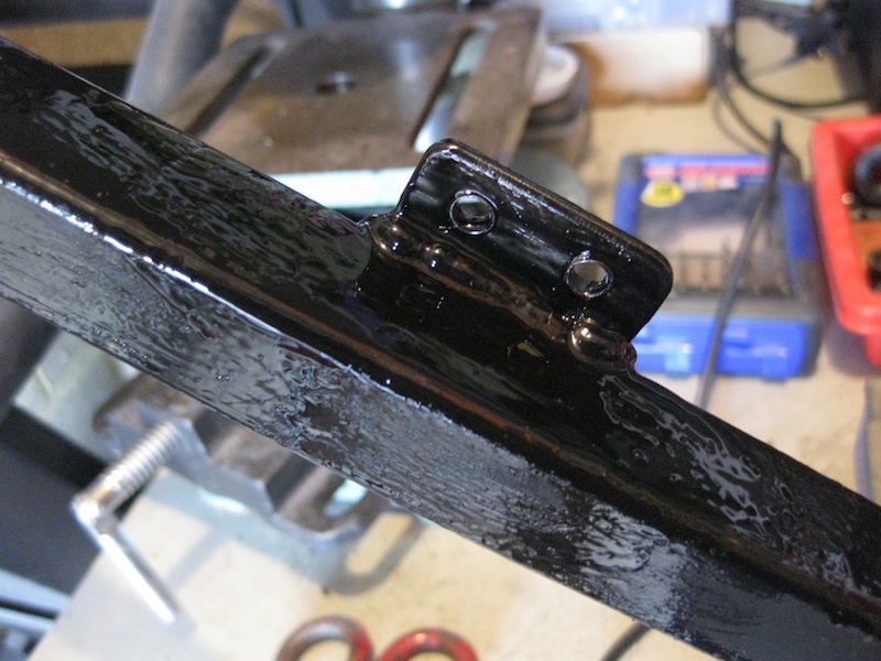

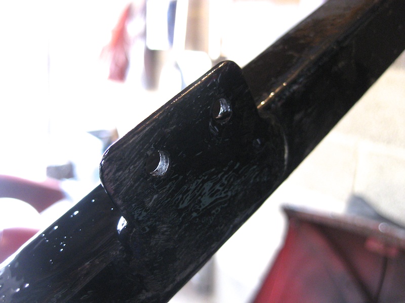

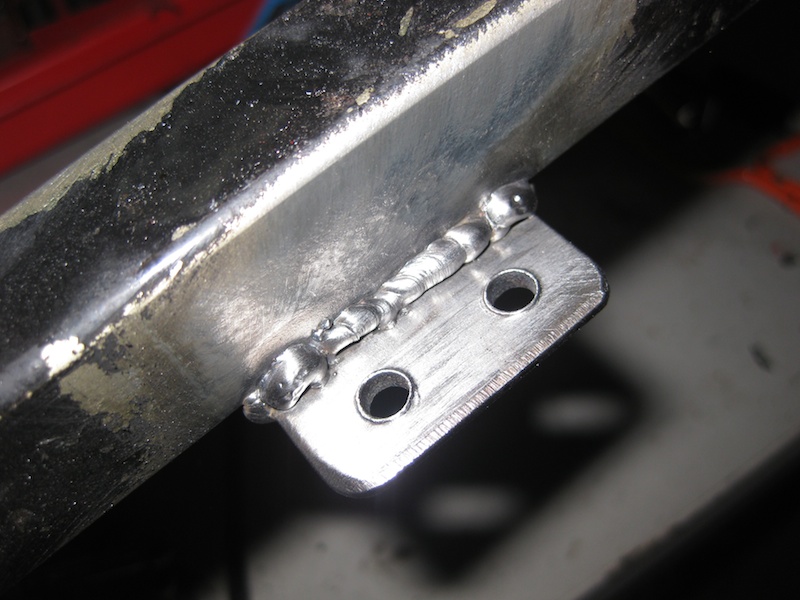

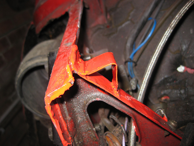

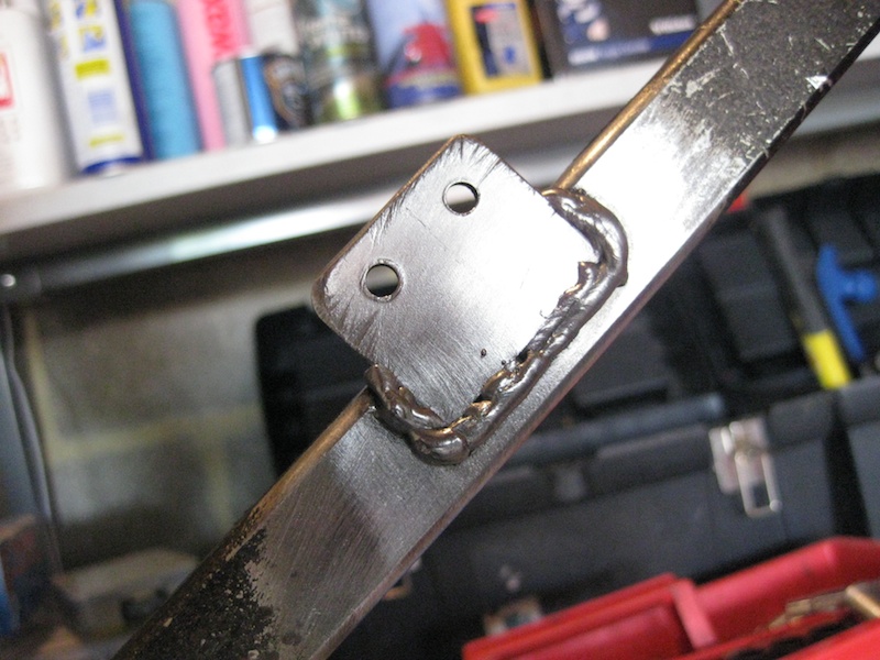

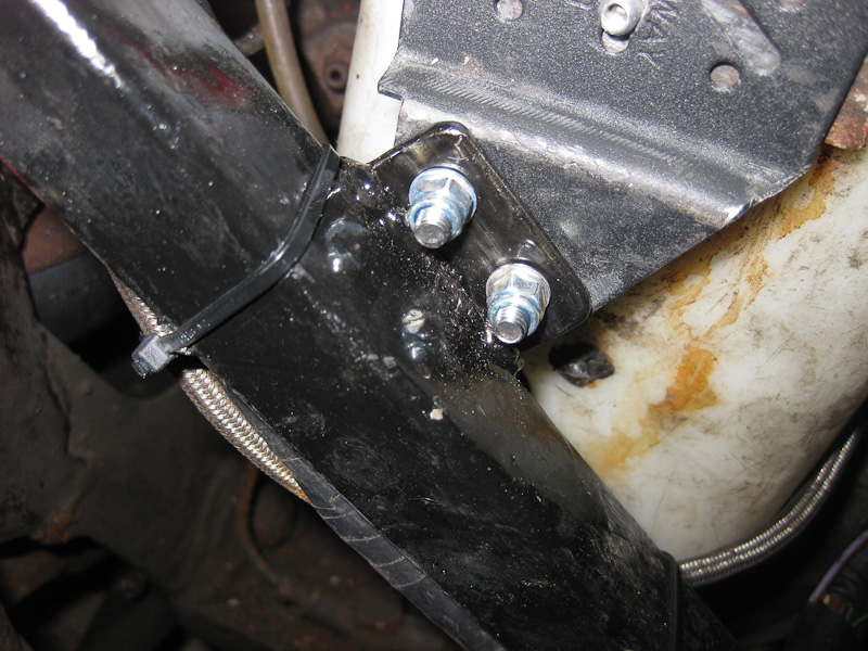

So, I spent an hour in the garage this morning - I wanted to make a mount for the washer bottle (that used to be mounted on the inner wing). My plan was to essentially weld on a tiny tab onto the brace bar, meaning that I don't lose any of the newly gained access after removing the wing.
So, I've only just got a welder - have failed when practicing, so why not have a go on your actual car, right? Ha!
I think I've done a pretty poor job - but, it functions OK, and I'll bolt it back into the car later to see how it all fits.
My welding was terrible - it seemed to be on top of the metal rather than in it - but after grinding it back before smashing a load of paint on it, it did appear to be in both bits of metal - so it'll do.
Because the box section is thicker you needed a bit more power/bit less wire there to get good penetration into the box rather than it sitting on top. But the main thing is that it's attached and it is all good practise.
It looks like you are moving the welder straight down the join. you need to move it side to side in a sort of z pattern down the join, then you ensure you get proper penetration in both bits. I'm sure it will be fine for for a screen wash bottle though.

Thanks for the tips guys - next time I'll try both tips and hopefully improve. As you guys say - for this application it'll do. :)

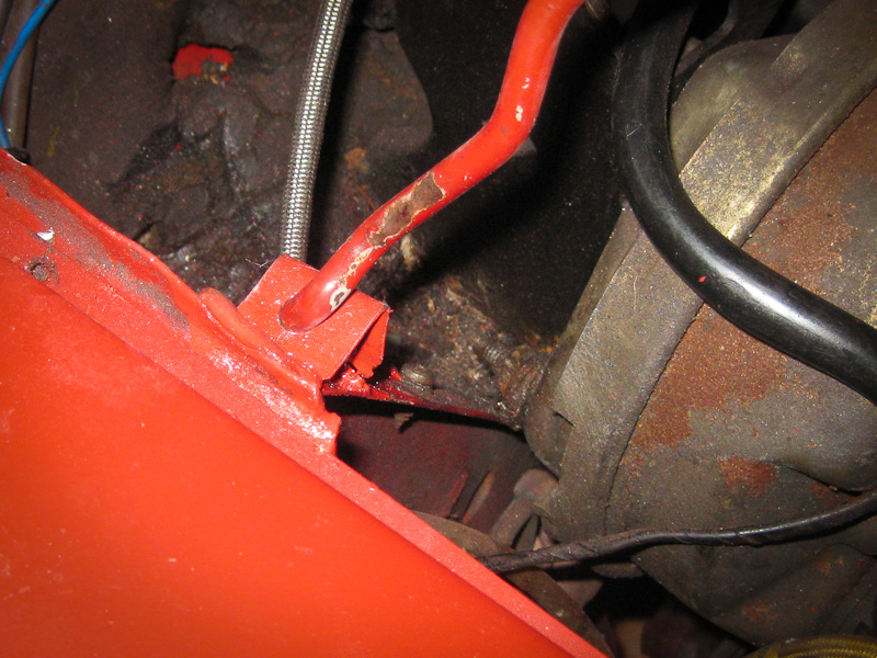

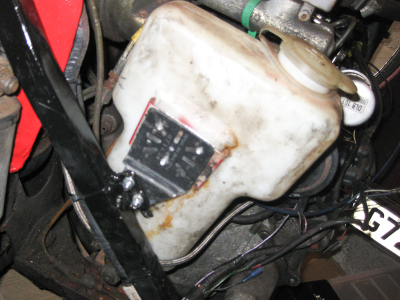

So, spent a bit more time out in the garage after the end of the Silverstone 6hr. I refitted the subframe brace, fitted a washer bottle bracket I knocked up as a trial (and it'll do until I buy some proper metal to make it out of), I also decided to stick on a new bonnet stay thing, since losing the inner wing meant losing that. I decided to tack it onto the bulkead/wing support bit, as that would mean that the bonnet could be left on with the fibreglass frontend removed.
Oh, and I found out that it has quick release hinges fitted already.. and they are shit. So glad I didn't pay for them - binning them as soon as I order some pins.
Pics below, as always. (Sorry for the blurry/shit photos btw, using a crappy camera in the garage so I don't ruin my proper one).

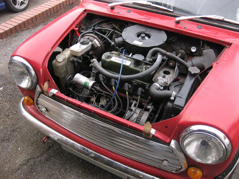

No photos today, but a good update - Ric came over today and we did the clutch, so the car is now working again. Easy job really, without any issues. Having the removable front made everything easy.

Just a quick snap I took at work today, proving that it does in fact now work despite me taking it apart yesterday.. ha!

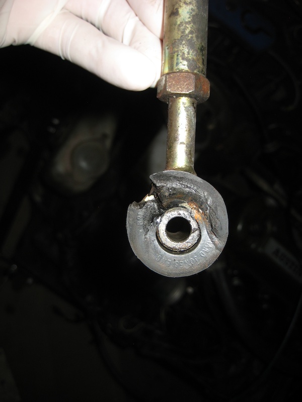

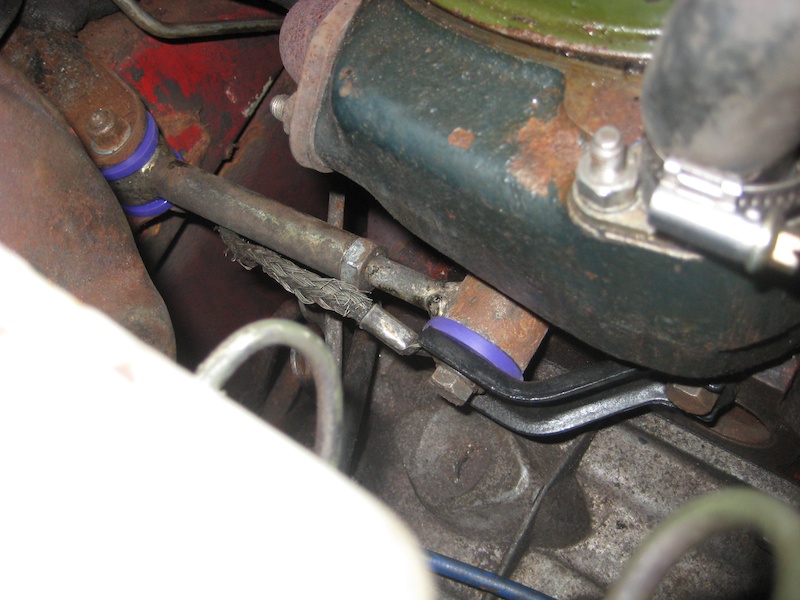

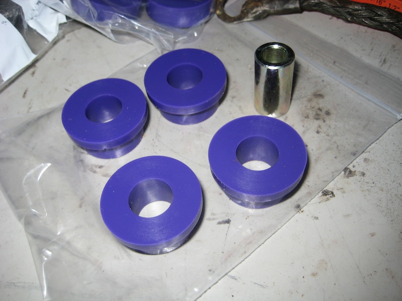

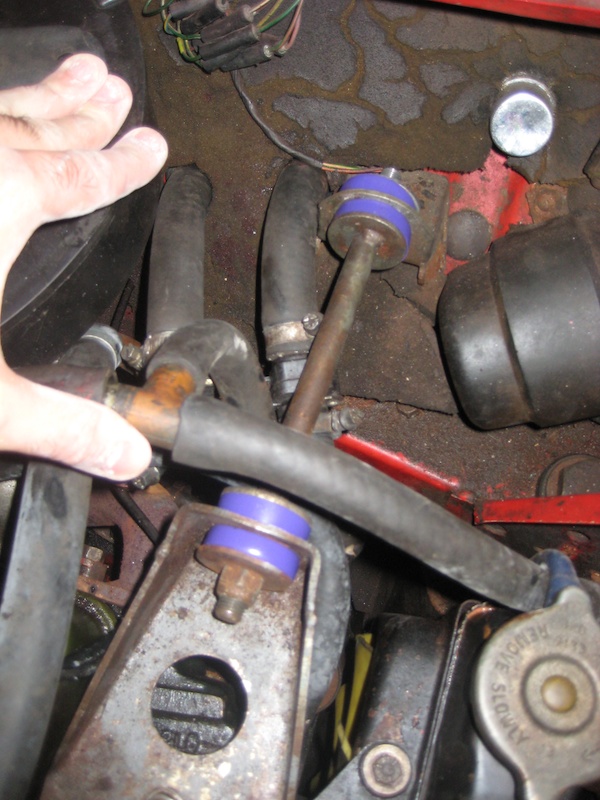

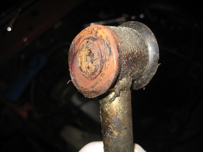

Today, I replaced the engine steady bushes, which were shot.
As I said, nothing major!

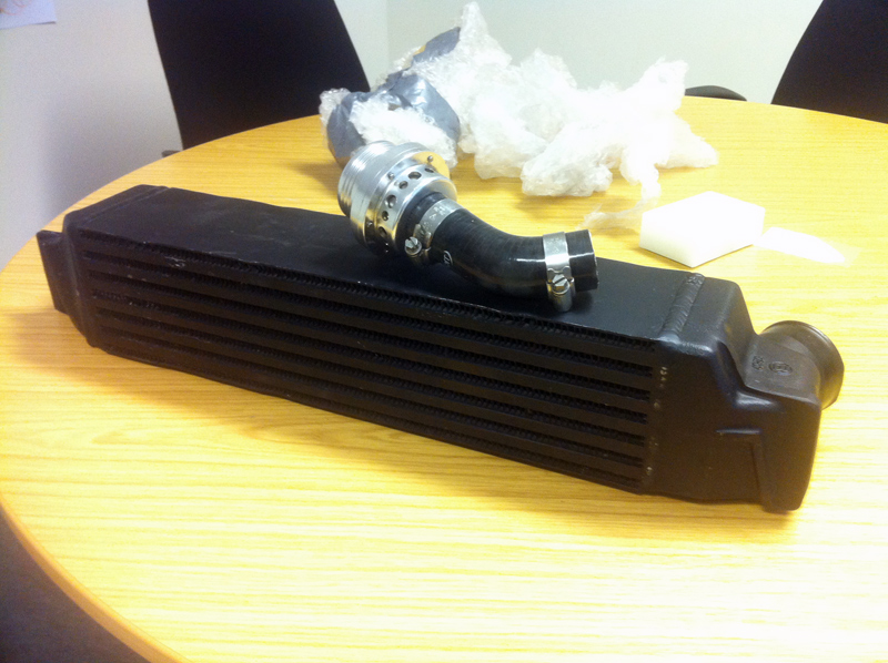

More bits to add to my huge pile of parts - Intercooler and dump valve arrived today (Cheers Oli!)

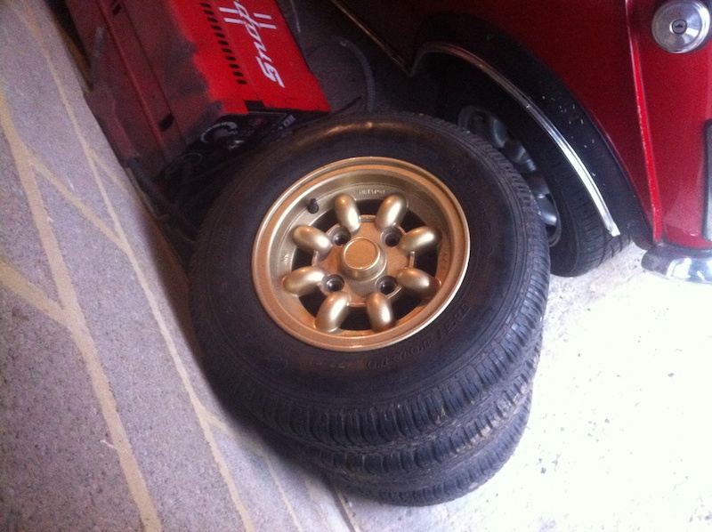

So, not much to update really as I have been on holiday in Devon. I did manage to pick up a set of wheels while we were there though *wink*
Also, a package from Minispares arrived too.
The wheels are just 5x10 Minators, and obviously won't fit over my 8.4" brakes, so I've got a set of 7.5 stuff coming from Paul S which should be here next week.

Those wheels will look mint *smiley* what arches are you going to run?
6297 Posts
Might not need to run any with 5" wide rims - we'll see.

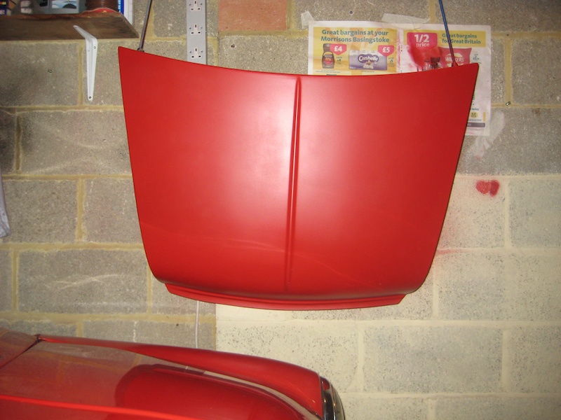

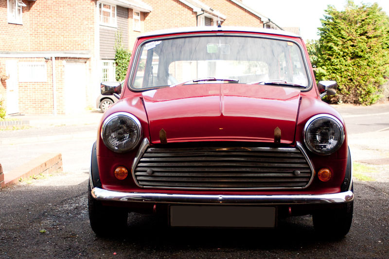

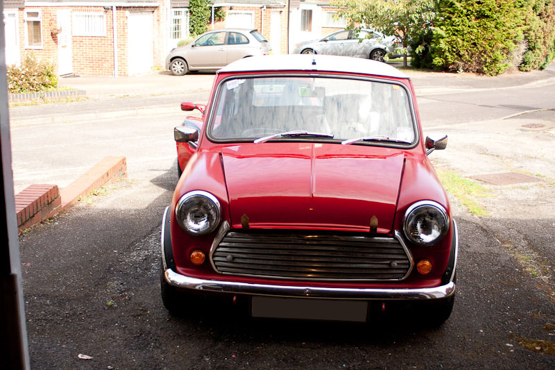

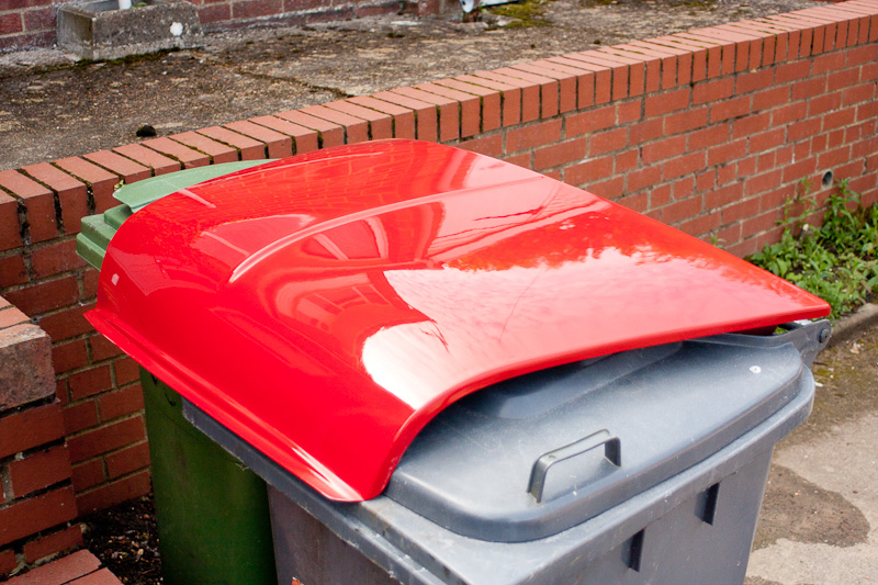

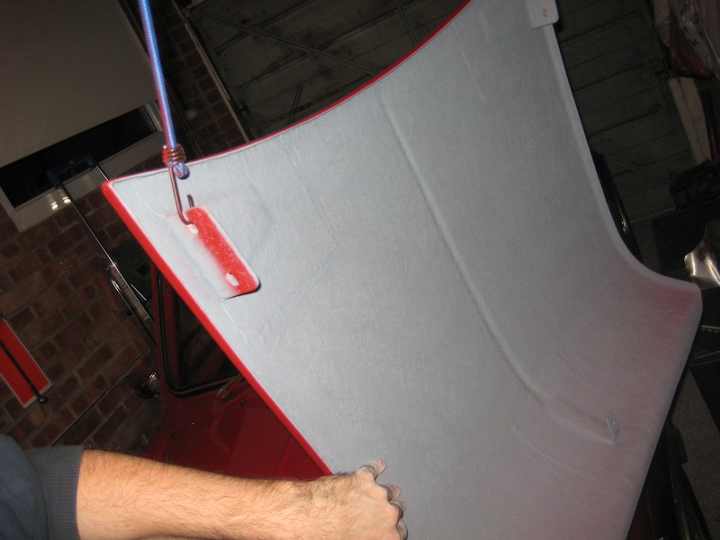

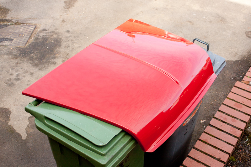

Just finished the bonnet's paint. Pretty happy with it really, it's not perfect, but it's better than anything I've painted before, and it'll do.

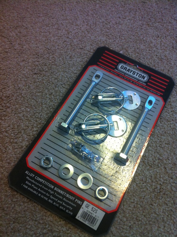

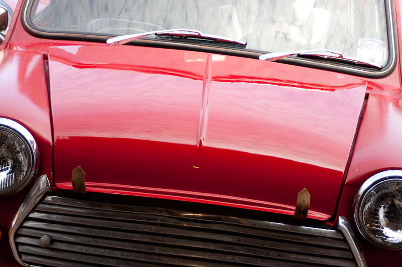

I'm going to spend some more time on the car later/tomorrow and weld in some plates for the bonnet pins, then work out a way to not fuck the bonnet by drilling the holes for them!
Also, really happy with the colour match - I got the paint from Paints4u.com, and will get more from them when I need it.
Edited by AlexB on 22nd Sep, 2012.
Hole shears.
http://www.lawson-his.co.uk/scripts/produc...0hole%20cutters
You get a good clean hole with no burrs and no heat generated to mess the paint up.
