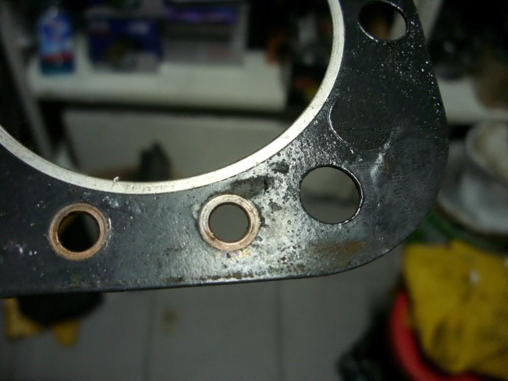

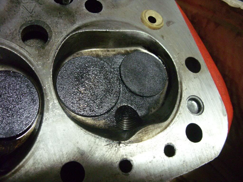

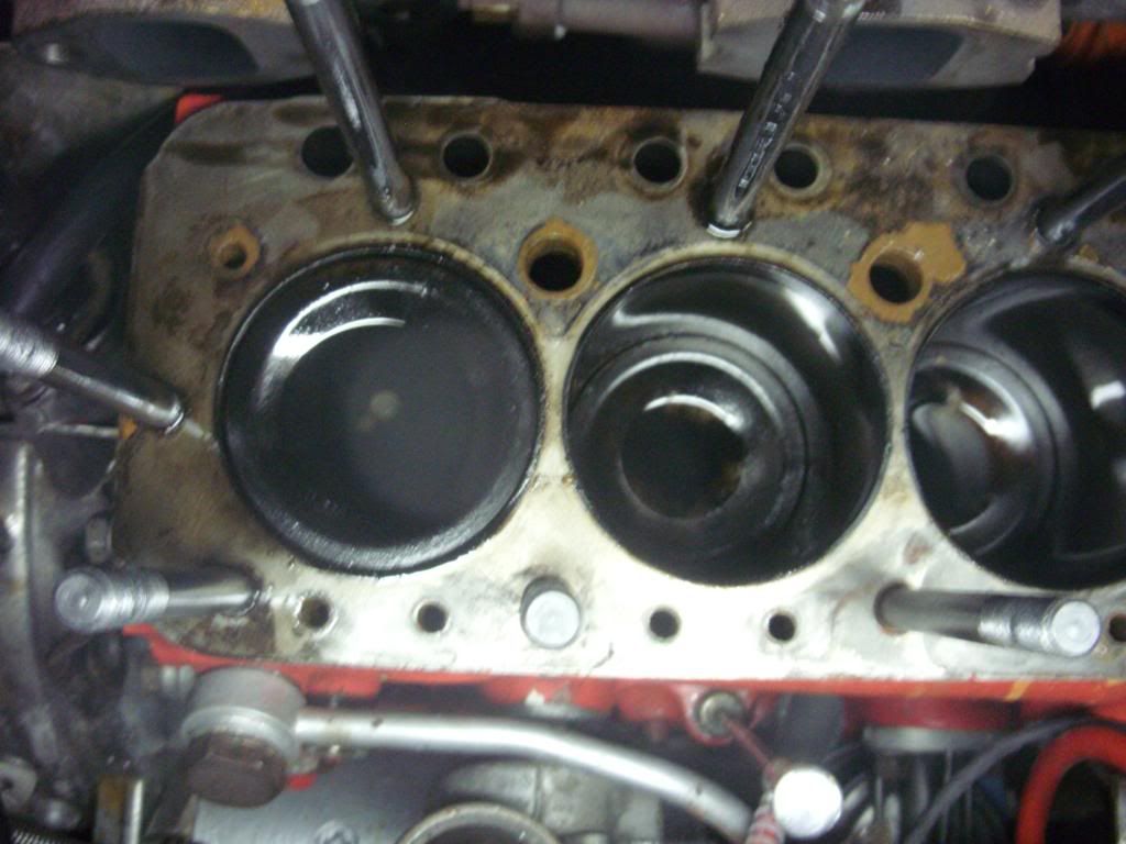

well finally managed to pull my finger out and work on the mini... pulled the head off and the gasket looks almost new.i dont know if thats good or not as that was my main suspect.
i took some picture to show you guys and see if im missing anything obvious before i put it back together.. any advice greatly appreciated
head gasket:
place where the head gasket stuck to the cylinder head(only thing wrong that i can see with the gasket)

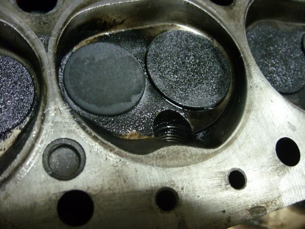

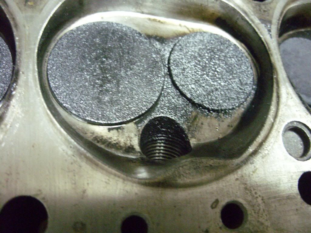

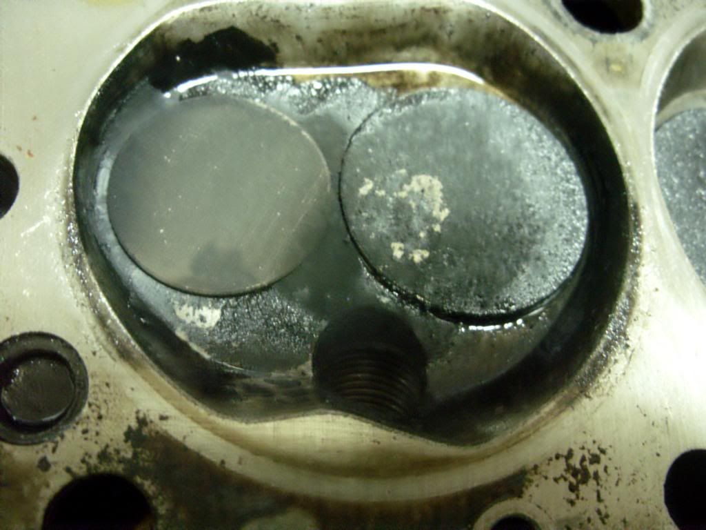

cylinder head with some head gasket stuck to it:
cylinder head:
pics of each individual cylinder

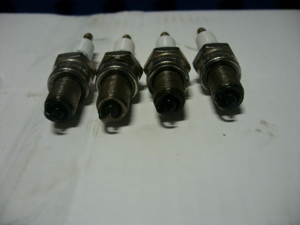

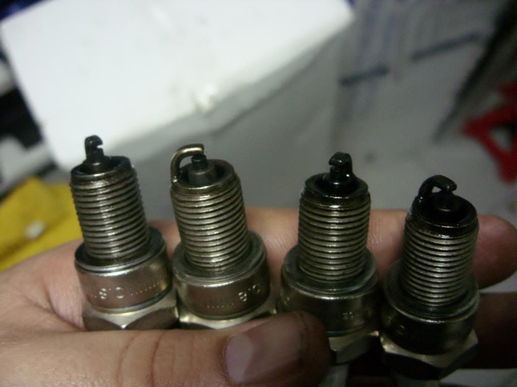

spark plugs
starting from the left,cylinder 1,2,3,4 number two look like it was hardly used,same thing if you look at the cylinder head, it has a lot less carbon build up.

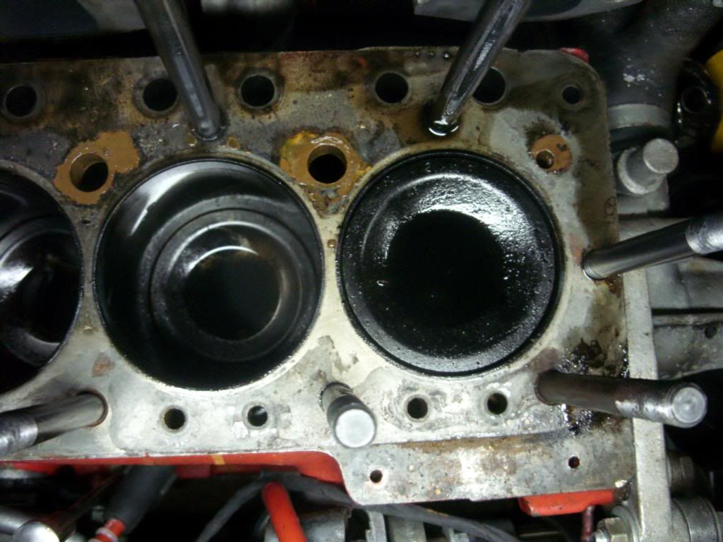

Block:
bores:
what do you guys think? should i just slap a new gasket on there and see what happens?

for the price of a gasket i would give it a go, i would check or replace the valve stem seals whilst its apart and might as well lap the valves while there out,
the wet compression test suggests the rings on atleast the first 3 cylinders are in decent shape, the valves or head gasket hopefully to blame for the slight lowering of compression
and that leaves the mainly stem seals or turbo for the smoke
dont forget to thoroughly clean all the old head gasket off the head and block also get some proper rust inhibiting coolant in there *wink*
Edited by Brett on 22nd Dec, 2012.

I'm going to go out on a limb and say either the oil control rings are cunted.... or the bores are polished to fuck.
