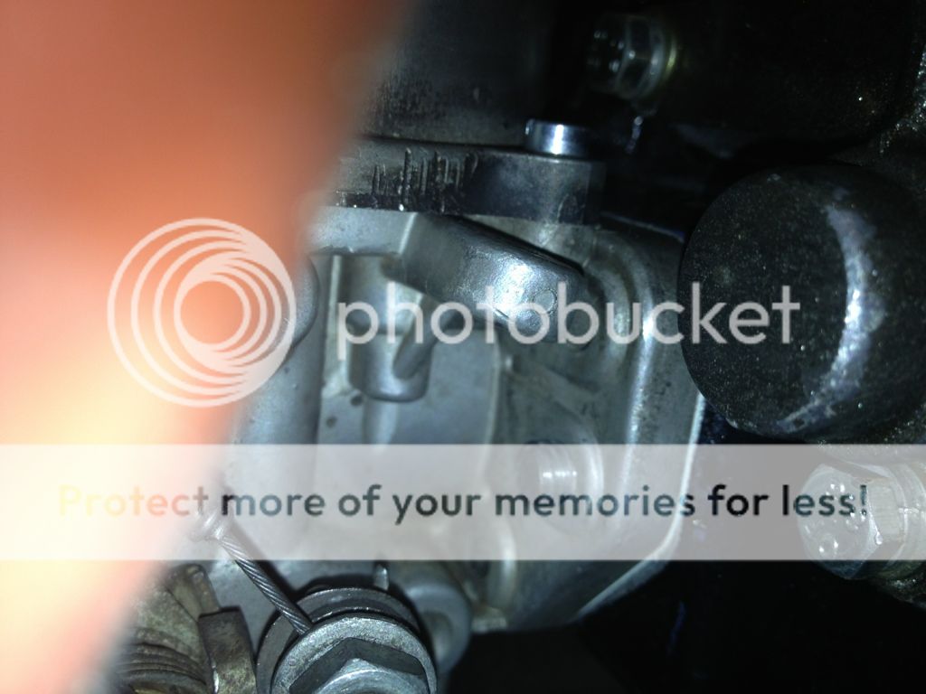

FOUND IT can you see the little pinhole in the carb flange just above and to the left of where the plenum stud is poking through?!

TurboMike1992
171 Posts
Member #: 9928
Hartley, Kent
Okay so i take the carb off and its not a hole. So were even more stumped
Low boosting for now.
Is it hissing from that area? If so, could it be the plenum/gonzo nose gasket?
Is the method you have used to block the factory dump valve, preventing the two faces from sealing properly?
TurboMike1992
171 Posts
Member #: 9928
Hartley, Kent
Yep! I think the little tag in the restricter ring was leaking theough a hole in the gasket. Just waiting on the mastic to seal it, will find out tomorrow, fingers crossed.
