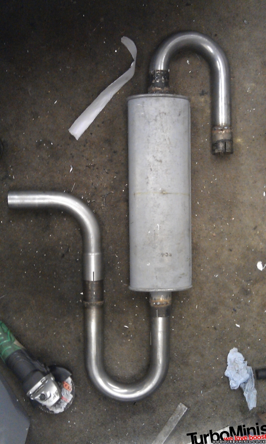

Well it now has a new exhaust, just needs fitting.
And now a before and after of the fitted item. Note that the foglight is now one of the reverse lights.
The downpipe knuckly bit looks quite low. Is there anyway you could cut and shut that to get more ground clearance? Or is the subframe in the way.

It's a bit of both. It's excayly the same height as it is on a mini, you just never see it from that angle. Not much you can do really.
It's the same height in both pictures BTW

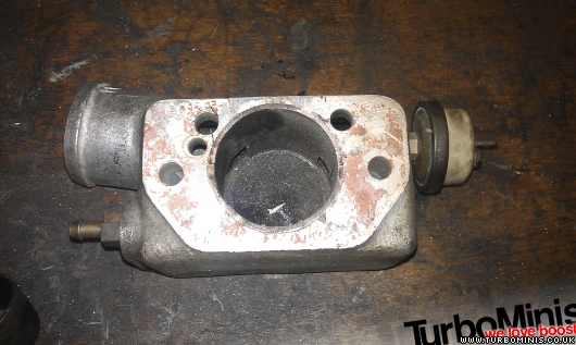

I took it down to Ben's on Wednesday, and the fuelling was shocking. 12:1 on cruise and off the scale lean on boost. A quick check showed that it had a standard BDD. I reckoned that the float bowl wasn't pressurising as the fuelling went so lean.

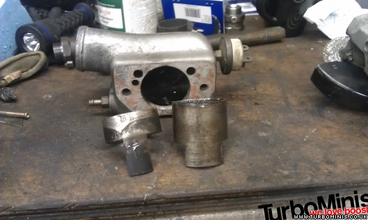

So I inspected the plenum restrictor. This is what I found - One fitted on left, new one on right.
The guy who made it obviously understood that the restrictor was important, but failed to make it to the correct dimensions. So it wasn't really a restrictor. The new on is a copy of an original, but a bit longer to fit this plenum.
Not tested it yet, but hopefully this will do the job.

That would defiantly explain the symptons. Interested to see the results.

Well that worked a treat.
Problem no is it's 17:1 on tickover, 12:1 on cruise and 10:1 on boost.
