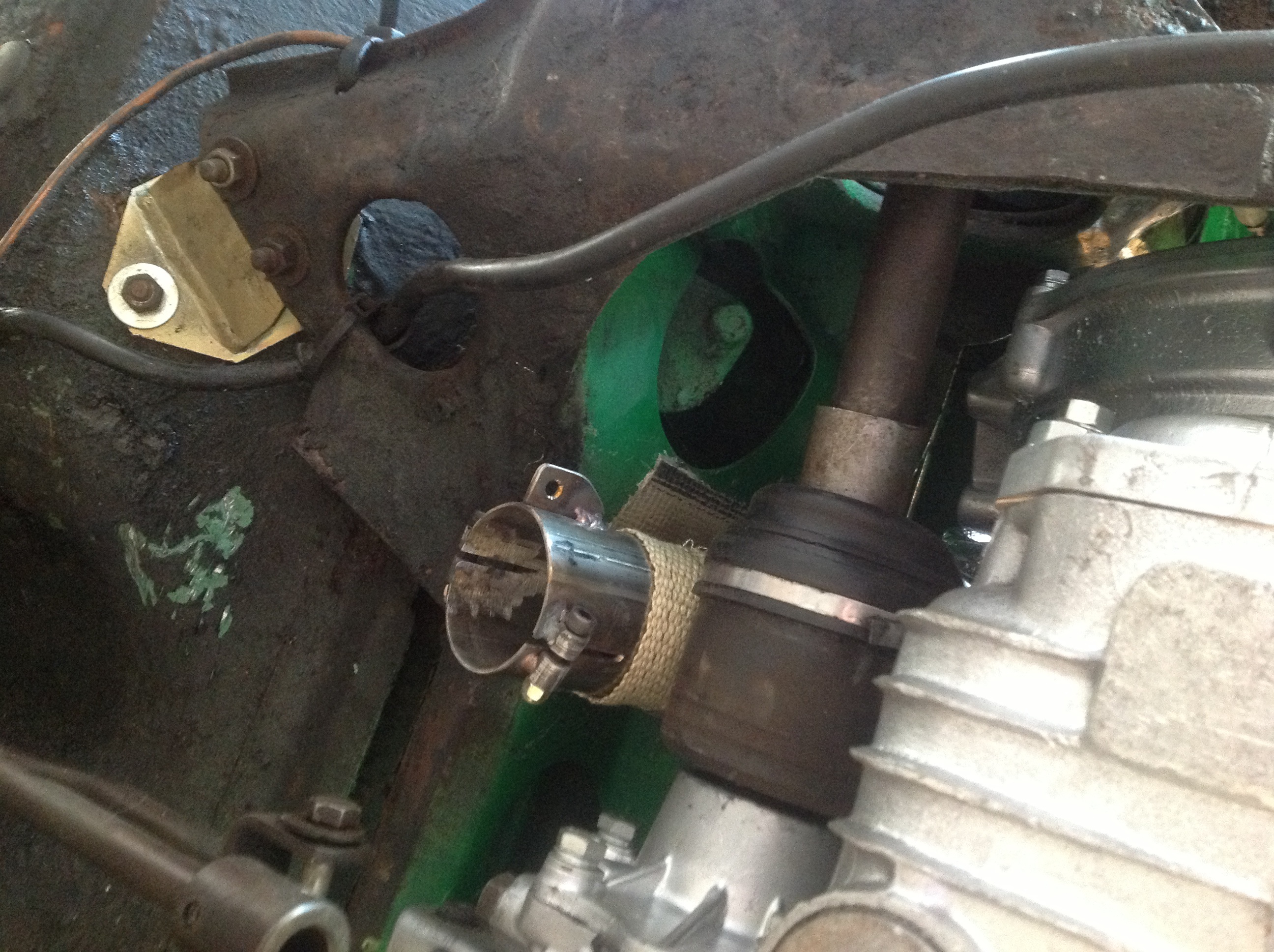

Well a quick update everything is just about set and ready to drop the engine in on Thursday when my oil drain hose arrives! just one other thing do you guys think this coolant hose will be fine here? It's about 20mm from exhaust manifold

although my knowledge in this field is very limited... ive seen turbos go cherry red so i would say that 20mm from the turbo was probably too close but as i say i dont know alot!

I literally can't see another way to get off the back connection as the hose can't go down because it collides with a web on the block I'm right in saying the alloy part of the turbo doesn't get very hot though does it? And it was 20mm off the manifold
This is what I use mate, just one end off
and fit you hose job done nice and neat

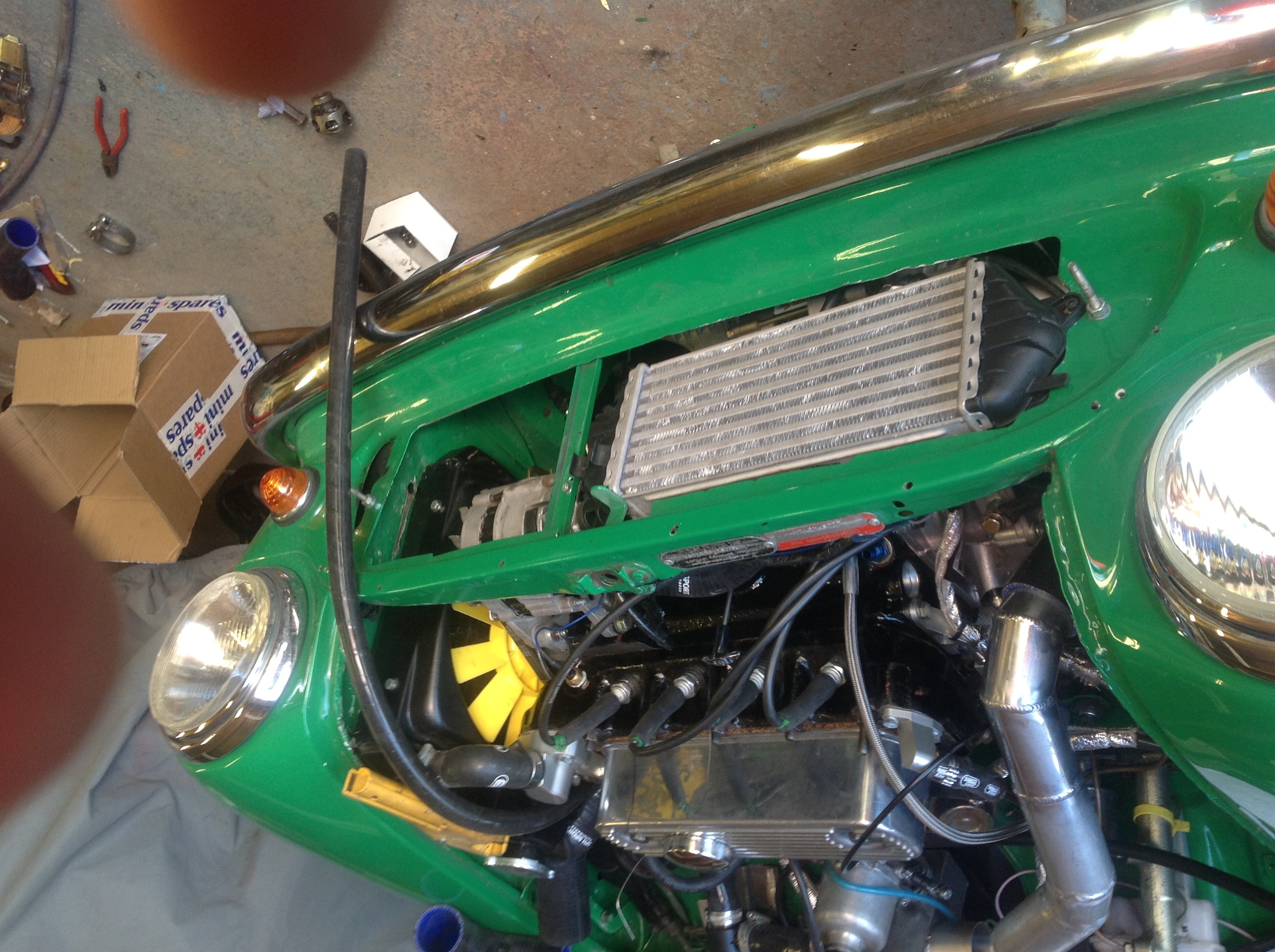

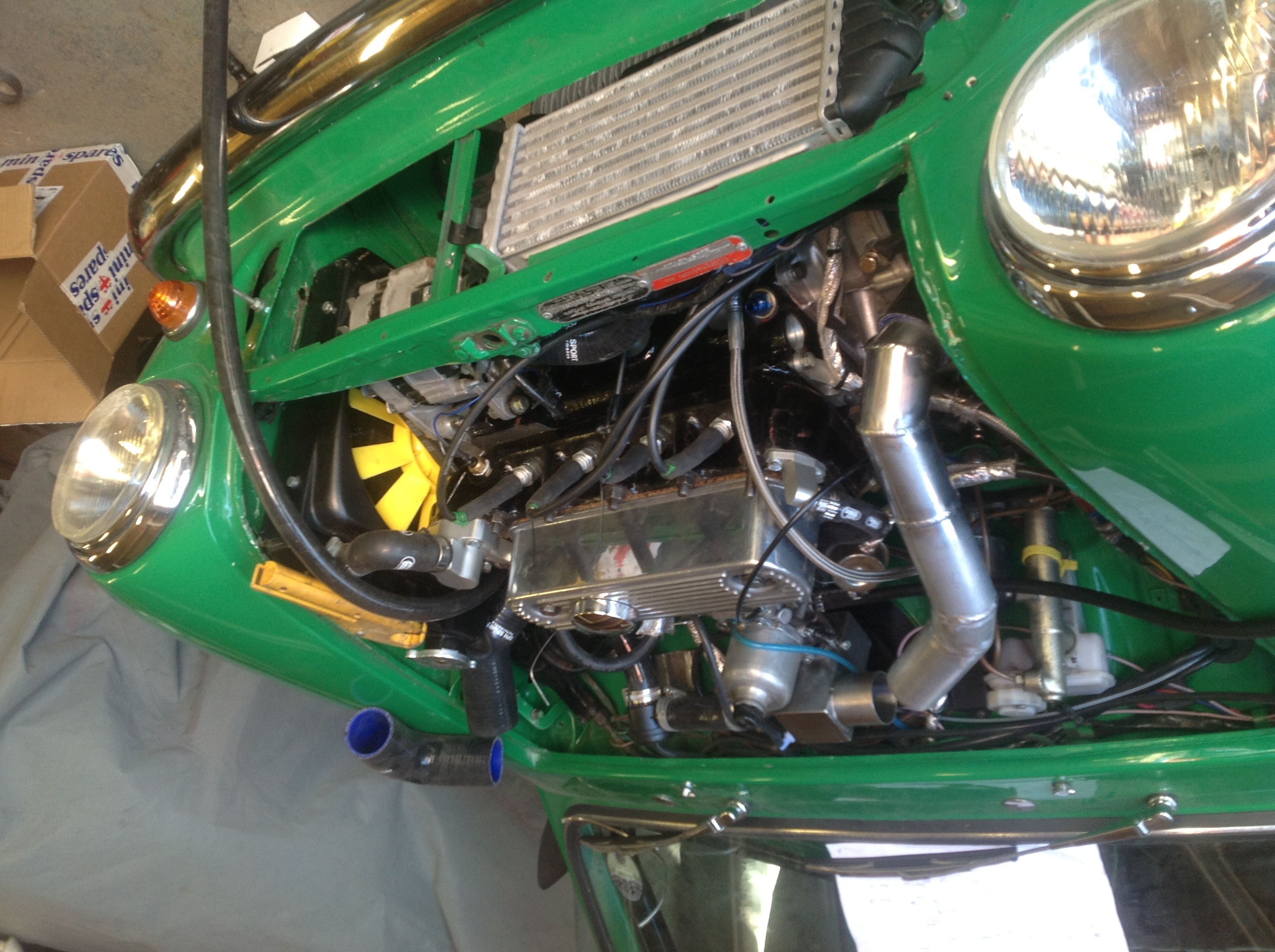

Well abit of An date sorted the fuel pump and tank out and it's looking very much like it will be running tommorrow! Here's a pic of how nicely the bini intercooler fitted in the end! And does anyone know where I can buy another one of these pot joints with the steel sleeve fitted? C
