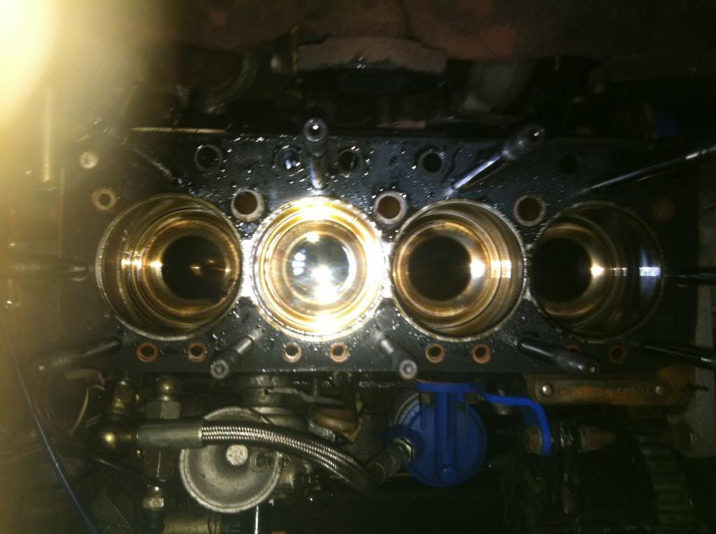

turbos done but it still smokes now mainly on overrun so will send the head to slark in a couple of weeks for new guides:/
charlieb150
517 Posts
Member #: 9931
brighton
this explains the smoking lol was guides they were fecked :)
oh yes. Mine was similar. the oil was running out of the ports and down the back of the engine...
charlieb150
517 Posts
Member #: 9931
brighton
mine wasnt quite like that but its been smoking it tits of for the last 2000miles
