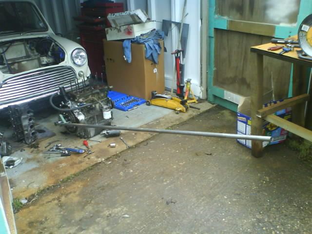

That's ridiculous! I didn't need an extension bar I was going fine with my 24 inch bar it just went.

Imagine trying to hold the engine with that bar in the end! Madness
easy left foot against the block right hand on the the bar and lean. lol

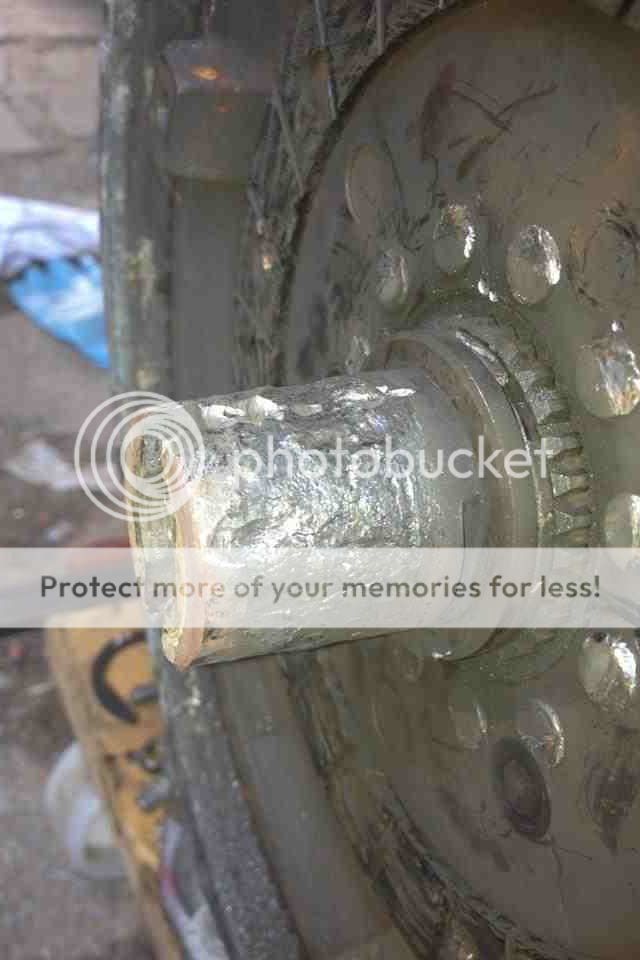

They are rait ard. Lol it's got a bit of marking in the tail. I'll try and get a picture.
Mike will be able to comment on the damage. Are they repairable?
On 17th Jan, 2013 bakker110 said:
I reckon it was just mikes strong arms.
That can't be the Mike Race I know, he's an 8 stone weakling.
No probs pal Its purely down to me being a double hard bastard! The damage to the crank didn't look to effect the taper to be honest. Slap some pics up.
