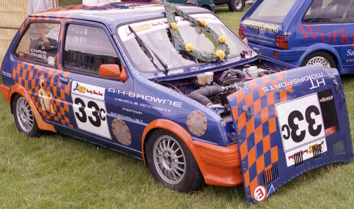

When Jon first bought it, it still had the checkers on, should be some pics of it on here if you have a look?
found a piccy with Gromit on the side:
http://www.grsmotorsport.co.uk/metrochallengeracecar1.jpg
Rob, cheers for that.
Tom, i had a look but couldn't find much. Got a few now of the car through the years with Jon. It has varied at times a he got rid of the orange on the bumpers and bodykit for a while

Just found a better photo of Grommet:
http://www.geocities.ws/martinsmetros/MGM2001/mgm.6.jpg
Edited by Rob H on 5th Sep, 2014.
The more i see these old photos the more i realise i need to get this car painted and back together
