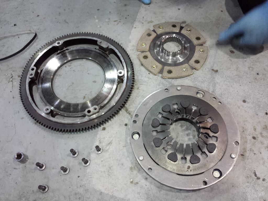

I've got an early med ultralight, the prototype in fact. Not had any problems with the ring gear yet :/

Interesting. Have you bolted a clutch to it yet?

Yeah did about 1k miles, then swapped for a paddle clutch! Done about 50 miles on the new clutch setup.

I had a good nosy over one of those at Bingley and my only concern was with the use of an RTS, there just didn't look like enough meat in the flywheel behind the steel friction face for it to be rigid enough.
Just a thought
Since mine was fixed, I've not had an issue after 3000+ miles of abuse.
