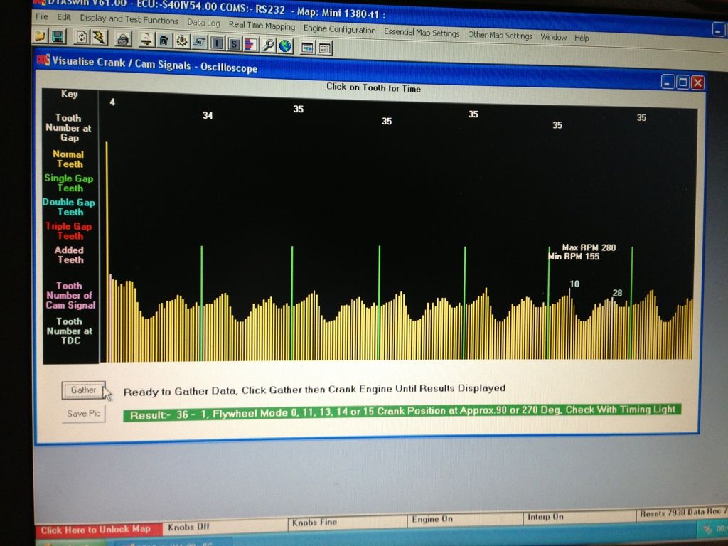

The fuel pumps on its own switch separate from the ecu... This is the crank oscilloscope
Thanks chaps rich
What type of crank trigger wheel have you got on this as that scope looks very odd, suggesting the crank trigger set up is where your problem lies.
Check the sensor gap is no larger than 1mm. Also check that the sensor is wired correctly in the first instance since some ECU's can still work with the wiring inverted, all be it not very well. Perhaps the sensor shat itself and you struggling to start it previously was a sign that it was about to.
Compare your picture to the one in the DTA manual here http://dc391.4shared.com/doc/sGh-SZV5/preview.html and you'll see the difference. Having said that, your ECU is already telling you it doesn't recognise the trigger, and will be the reason why it's not sparking, since it doesn't know when to fire the coils.

Lol Oli that's what I've tryed for the last 2 weeks!
It's an med trigger wheel/ pulley with there bracket, I did check the gap at 0.40 but will be wiring it the other way around this evening and I also have the other sensor that was supplied with the dta (I'm using the one that came with the med bracket)
Thanks for all the help, ill let you know how I get on later :)

Getting somewhere now, took the sensor out and it did have metal filings on it, also switched the wires around on the vr sensor and voila it's sparking and trying to start. This is the crank oscilloscope now
Going to give the plugs a quick clean and gap and try again
Thanks :) rich

And it runs *happy* best ring insurance company tomorrow!
Thanks again guys
Rich
Avon 2010 class c 3rd
Glad to hear you've got is sorted
excellent mate!!, do you have a timing light? to double check what the ecu says is what the spark is doing? worth checking now to be safe
