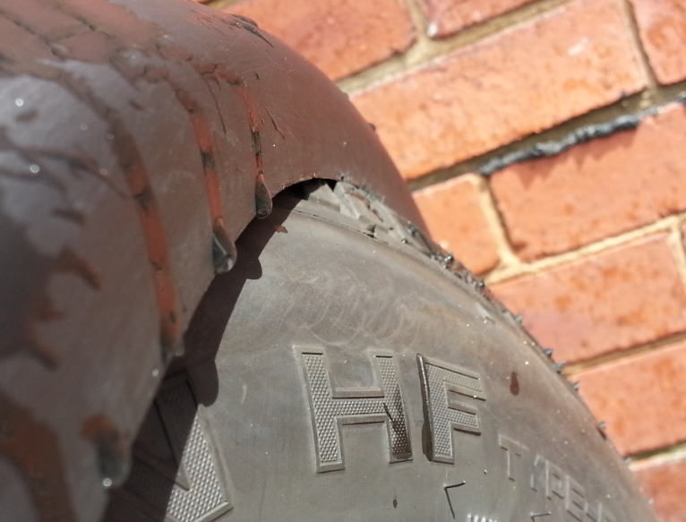

yeah there is some travel, took a fair bit of work though, gaz low height adjustable shocks and the higher tower mount you would usually buy one or the other but i have both lol
you have the big wheels though, the 10x6 wellers can be tucked under the mig arches quite well

i have two finger gap all round with gaz shocks, find it rubs every so often on the rear dependent on passenger weight as its not been tubbed *oh well* (shocks are set about 7 clicks from soft) found if i set the shocks harder once they compress they take a while to release and continue to rub for longer.
do have grp5's arches fitted so only rubs on the body, front is fine as its less then a little finger off the bump stop.
wheels are 6x10's

ive got the gaz lowered adjustables too
and higher alloy solid top mounts
had the konis but like not have to take the shocks off to adjust >.<
will start from 6 clicks from soft and go from there *happy*
havent tubbed the rear of the mini cab so its pretty close to the body but not the arch *angry*
seeing if i can sort that out with some camber and abit more spaceringgg
