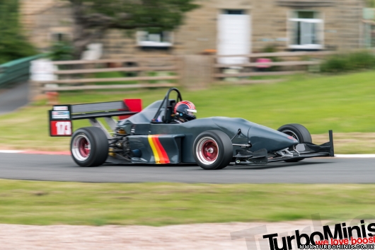

Here's a splendid photos of me in action - steady boys!
Looks like a lovely machine.

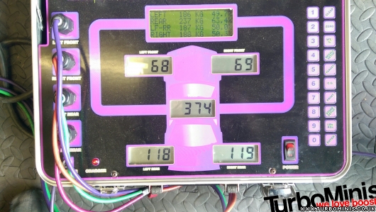

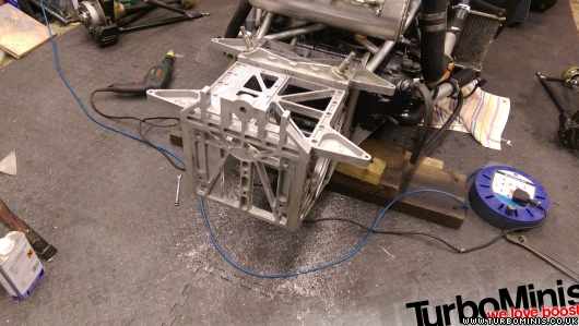

After a reasonable season the car was now reliable, but definitely NOT fast; we were propping up the bottom of the timesheets. So, going faster is easy - Less weight, more power, less drag, more downforce and more grip!!
Plonked it on the scales first
Eek, that's a bit fat. Most cars in the class are 330kgs, with a few 280kgs and some claimed less than 250kgs. After a bit of head scratching, we reckoned a 20kg loss was possible. So out with the grinders.....

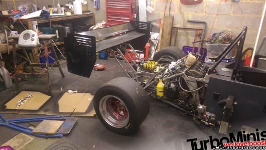

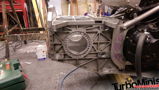

Started like this
and ended like this

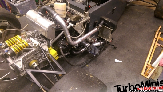

Lots of other bits made lighter like the boost hoses, the scavange pump, the breather system anf the rear wing end plates. I've also ordered a CF floor and diffuser to replace the GRP one.
The rear wing has also had adjustment built in to reduce drag, and the car will be treated to a new set of boots.

What is the new turbo?

New turbo is a £90 eaby special GT17 core.
Makes the boost exactly as the old one did.
Running around 15psi at the moment. A test day in March should see that rise a little:)
