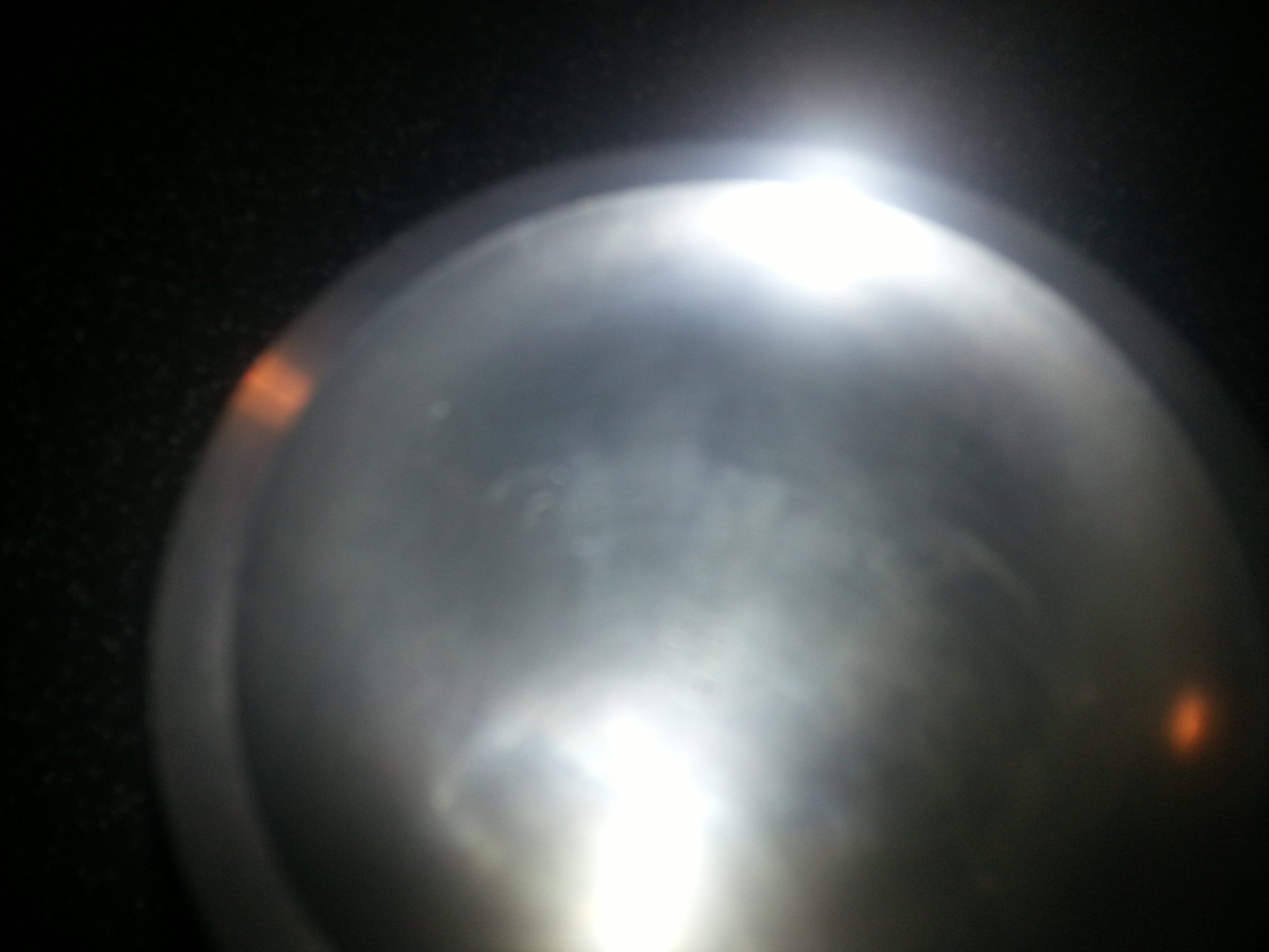

Anyone heard of OMEGA 1015's?
OP 120 is cast inside the piston.
They are for my non turbo 1071.
I think some people say the rings are rubbish but don't really know for sure.
I contacted Omega but no response*oh well*

my cast omegas were 1015s
edit- wrong pic but cant edit it *happy*
Sorry Brett
Post is ancient but do you remember the dish capacity on the Omega 1015's?
