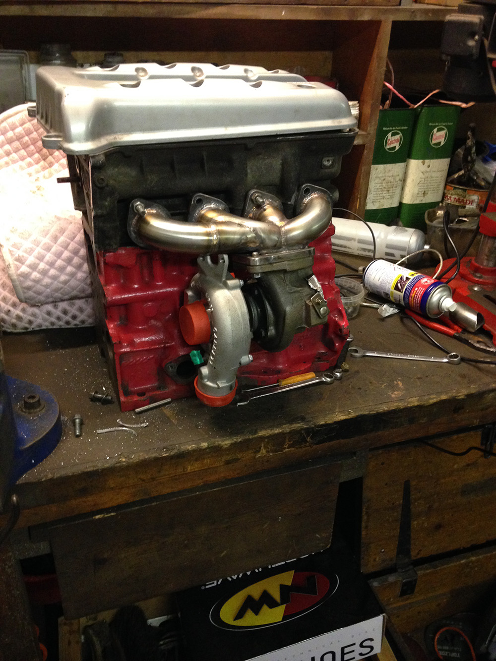

Onto if there has been any progress. Parts are still being collected. I have a pair of hot cams now as the LT cams wern't going to cut it. I will try LT inlet RS exhaust and go from there. I have also decided to go for a 73.5mm bore which should give 1188cc.
Got the exhaust manifold done, many thanks to Matty / fusion fabrications for welding it up for me.
Next project in the plenum using the BMW itb's which I have now sussed out so hopefully going to get that done soon.
