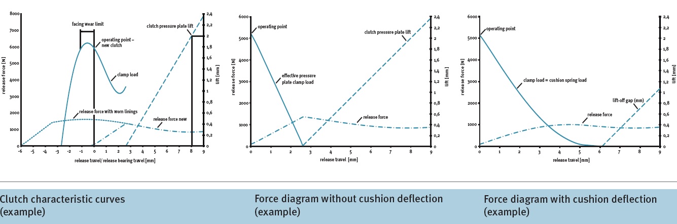

On 20th May, 2017 Joe C said:
I've not bothered, I think the lugs are reduced hight anyway on the med and mini spares ones.
In my experience the posts are taller such that there spring is under flat. It does seem counter intuitive, but when you look at the data for these type of springs, the manufacturer designs them such that the clamping force is just under peak. As the clutch wears it achieves peak and then drops off again to the point that slip should occur before the wear is so great that the rivets are starting to wear through on the friction plate.
This is why they recommend the clutch is replaced as a whole, friction plate and pressure plate together. Austin/ Rover only ever used to sell a complete assembly, flywheel included.
