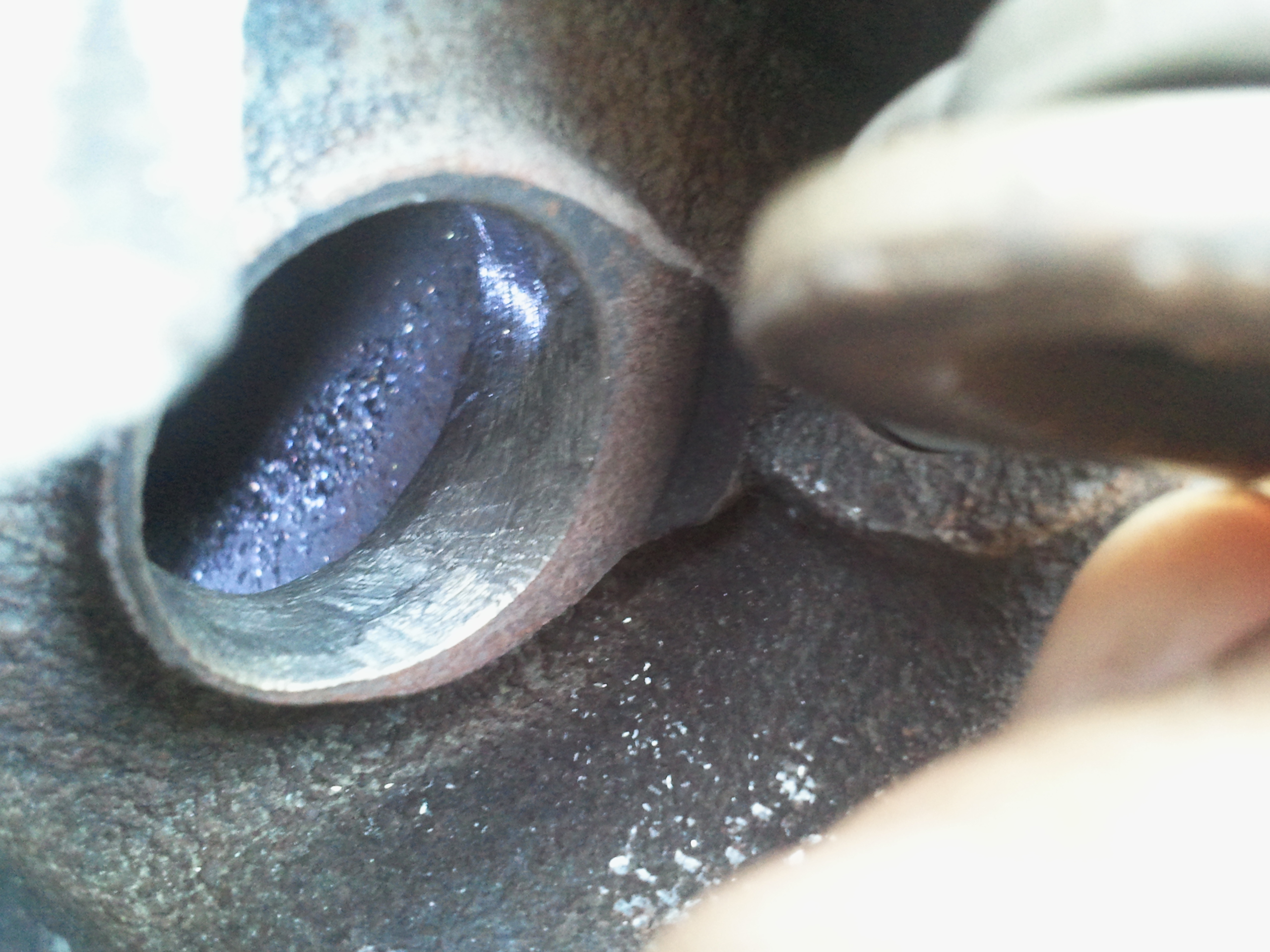

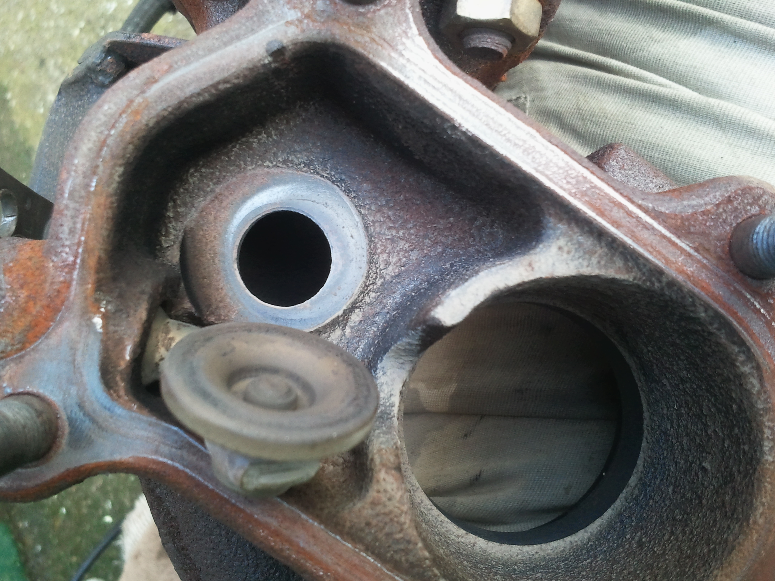

obviously there is the problem with the tiny wastegate, mine had a 23/24mm wastegate penny iirc and i managed to port the wastegate out to 21x22 ish mm and that was enough for me ( manifold and downpipe will have alot of influence with this )
i would recommend an external wastegate if your going for a K head with lots of revs....personally i will never run with an internally gated turbo again, i have this exact same problem on the skyline :( but that is a gt30 frame turbo squeezed into recast but essentially a stock sized exhaust housing
