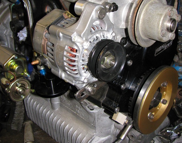

The talked about, milled standard pulley. and as you can see, its on the damped section (complete with splitting rubber!) so you can see if it becomes split any more how it might be allowed to flex significatly more meaning timing will shift
David.
90% use the milled damper without known issues. It's like a lot of things: If you don't measure the torsional vibration, then you don't know what variation in spark timing is happening.
