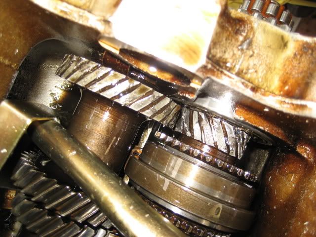

Well i started stripping the block to see how that was looking, 2 reasons, one being a drop in oil pressure when hot and the second being the obvious with the shrapnel.
The oil pump was seized and needed a shifter to get it moving again. The outer ring was very tight and had picked up a fair bit of shrapnel by the look of it so that is scrap for a start. Mains are ok but i'm going to change them anyway. Big ends were fine so far.
Will post up some photos later

a few photos of what we discovered when we went looking;
a bit of impact damage on the big-end nuts on 3&4
big-ends looked ok (granted a bit of light scoring)
oil pump needed persuading to come apart. The outer ring is heavily scored on the outer edge and has clearly picked up some debris.
found these gearteeth up in the block
just going to get my head into the oil pressure issue now
