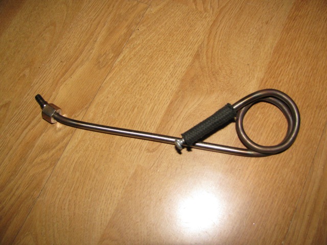

On 13th Oct, 2014 PhilR said:
In my head, I imagine several coils of brake line, with a rubber hose joining it to a pressure sensor.
PhilR
696 Posts
Member #: 10034
Birmingham
Exactly like that. Is that one long enough to stop it melting the hose?
It never got ran in anger before the project was shelved. Going back in a car soon though *smiley*
That looks a little bigger than "brake line"...
Do you guys think Kunifer brake lines will allow a sufficient supply of air?
Yes, that's 6mm stainless. I don't believe that brake pipe should go anywhere a hot turbo manifold.
I tend to agree.
Although kunifer or copper has much better heat transfer it will just sag under extreme heat.
Especially brake line which is relatively small diameter and small wall thickness.
IMO better a bit of stainless (properly supported) but longer.
Although I'm not worried about the heat transfer on my short sample chamber tubes, I think stainless was the best choice.
You could get better mechanical/heat properties with the right grade of alloy "mild" steel but not readily available on eBay and I wouldn't pay market prices for the really good stuff.
