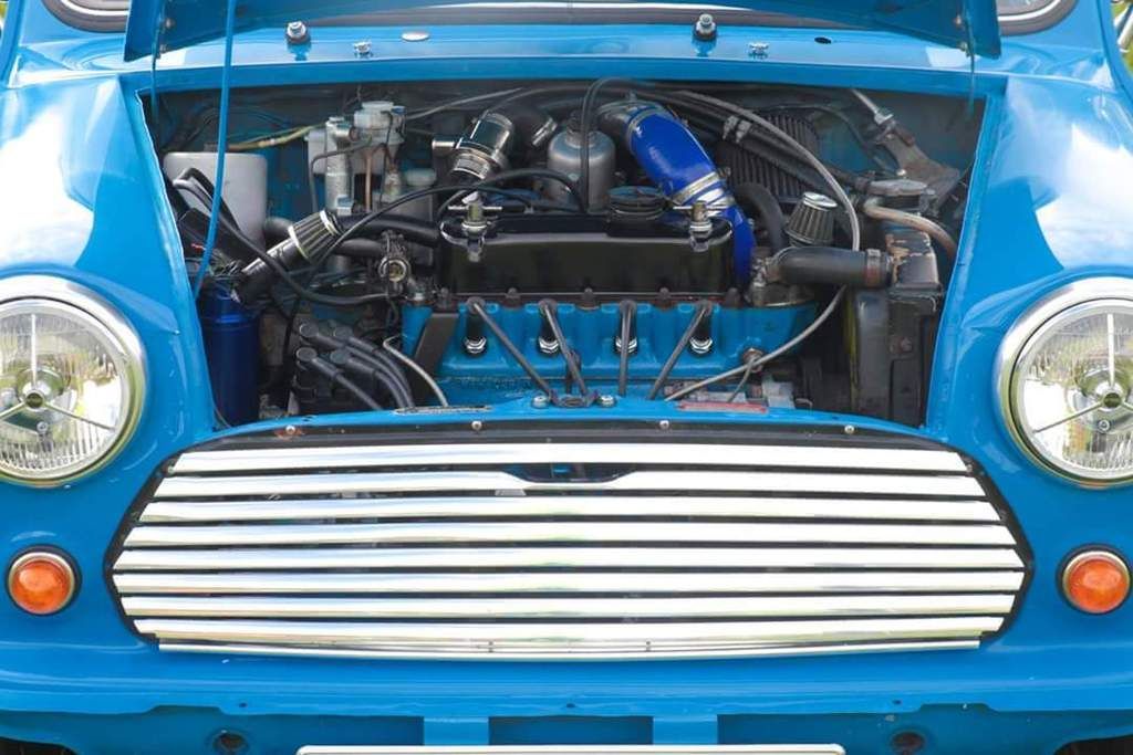

By coincidence someone posted a photo of my engine bay on Facebook this morning haha! Here's where abouts mine is atm, might be in front of the fuel pipes since its been off to do the head!

Same ^^
