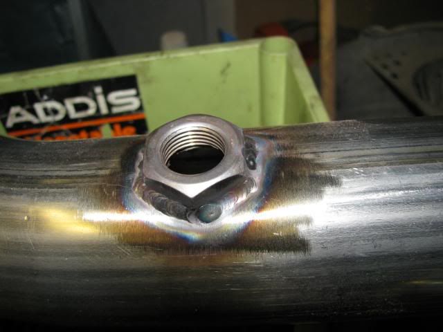

On 11th Feb, 2015 theoneeyedlizard said:
I'm using a piece of shit welder too. The only way I can get a decent weld is with the wire feed set to its lowest setting and the power as high as possible before blowing holes.
Once the new garage is finished, I'll be investing in a new one.
Gary, that looks perfectly acceptable to me, i have seen folk do much uglier shite than that using a TIG!
If you have clean and close fitting parts you can do a nice job with a TIG.
How folk manage a big blobby oxidised mess especially on stainless is beyond me really!
Nice. I'd like a TIG at some point. Lots of stuff to pay out for before that unfortunately.
