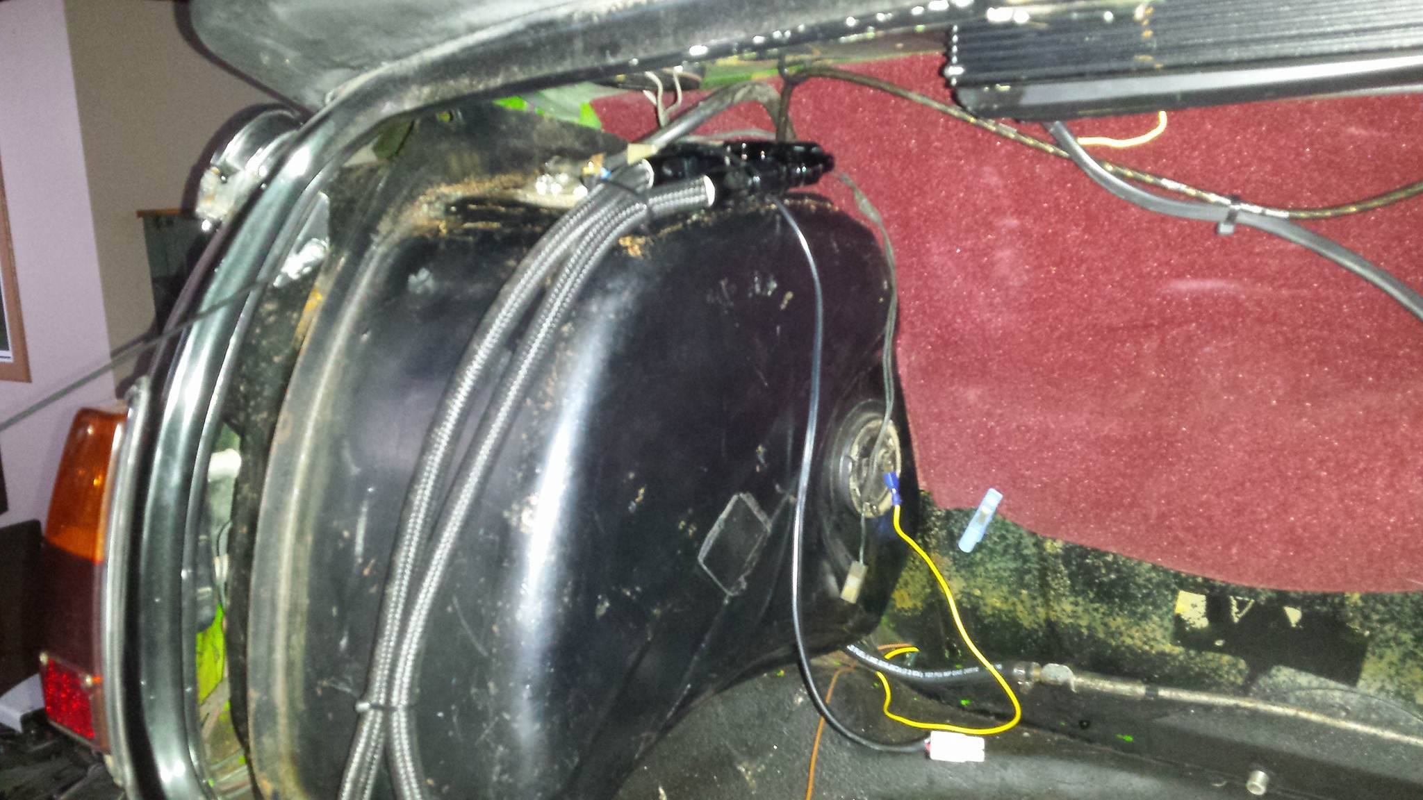

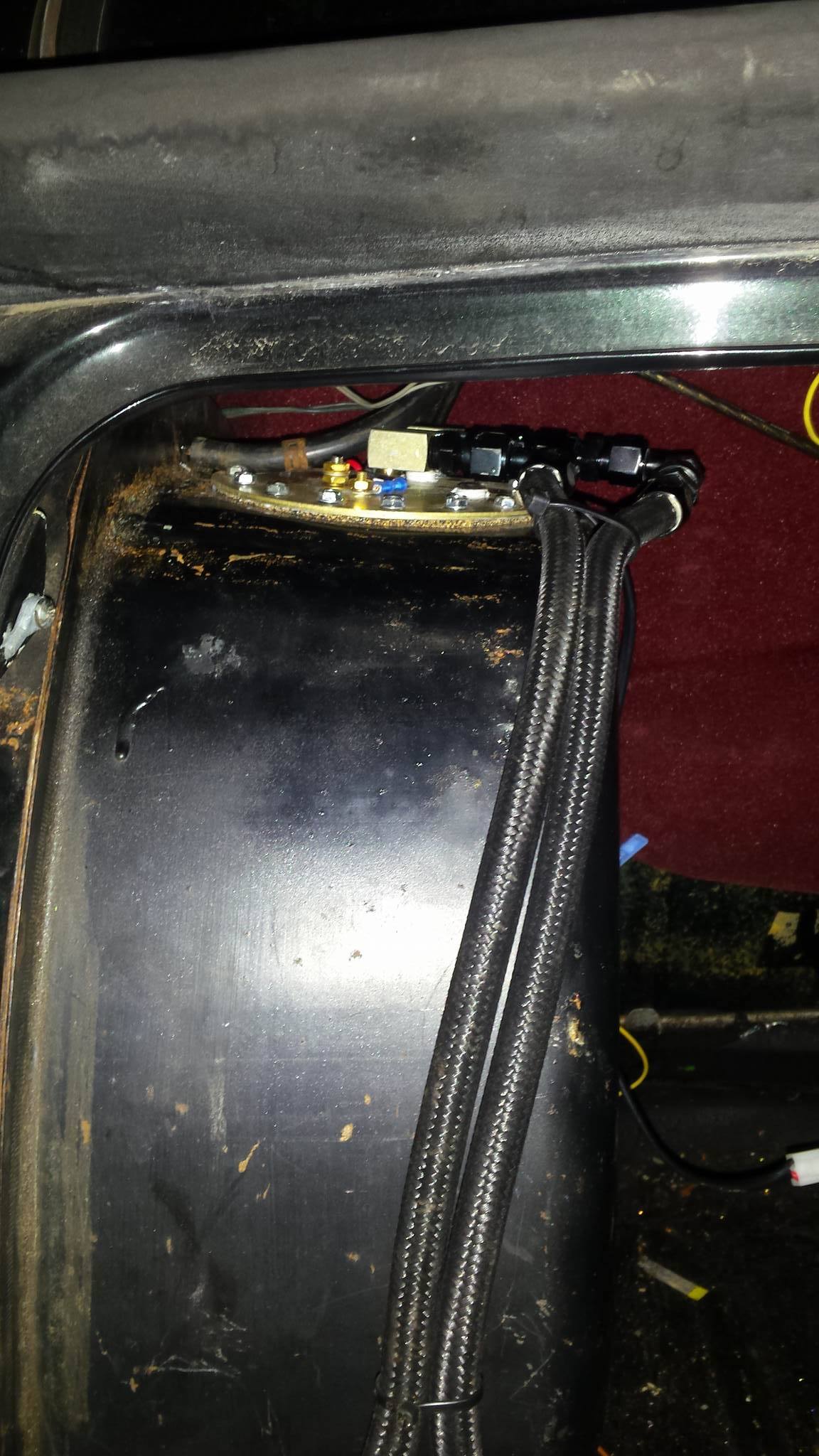

Well time for another little update ....
On the 1st of August we had a little boy named Mason @4pm @4kg so progress has slowed a bit more. now I have a small 2 hr window each day to nip round and work on it.

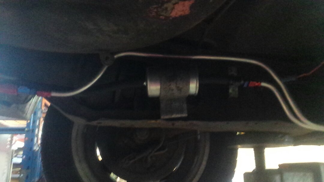

Many months ago I modded my 35lt tank to take a Walbro 190 intank pump with a kit from the US.
Over the last few days I have run the bulk of the fuel lines, reg and fitted the tank. tucked up in the rear subframe is the filter so it's easy to get at for when I want to replace it.
Hopefully I can pick up the rest of my clutch parts tomorrow and have the power unit sitting in it's hole by Monday.

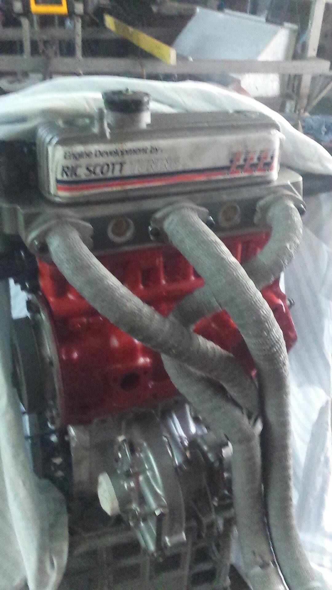

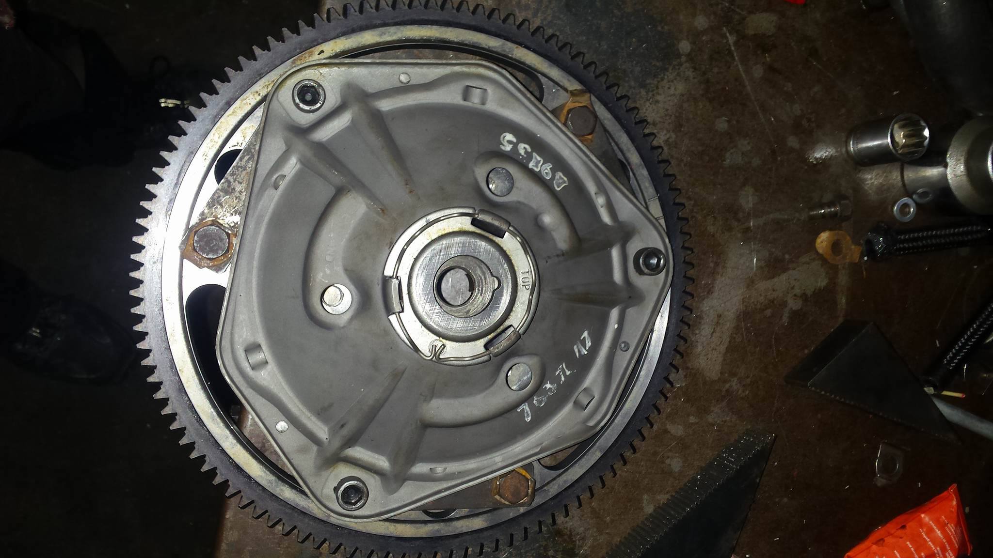

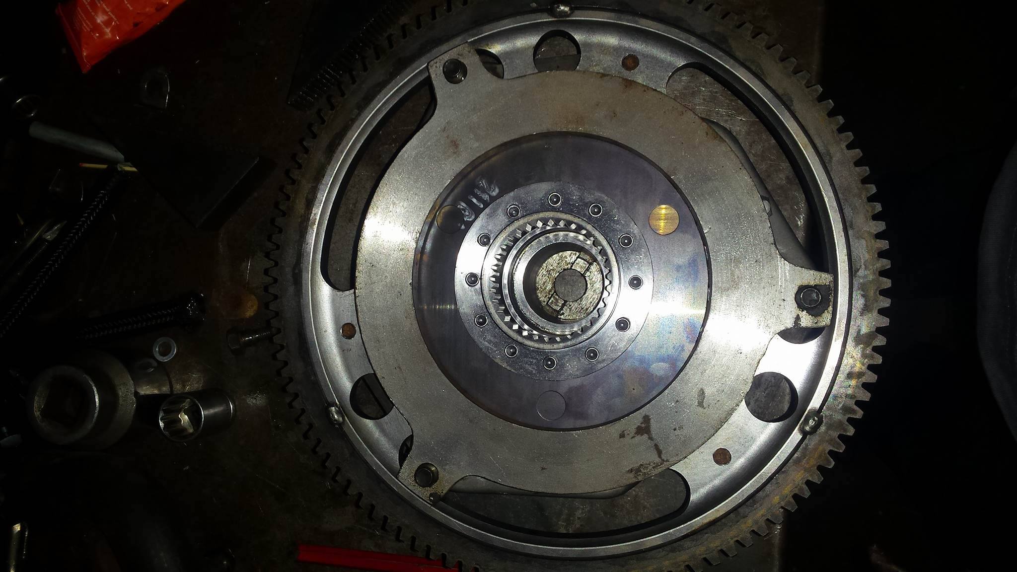

So after another 3hrs in the shed tonight I've set up the flywheel, getting closer :)
Complete flywheel / clutch comes in just under 7kg ... gotta be happy with that.
Had o shorten the stand off's for the drive straps by 65 thou to make it right .....every little step is getting somewhere.

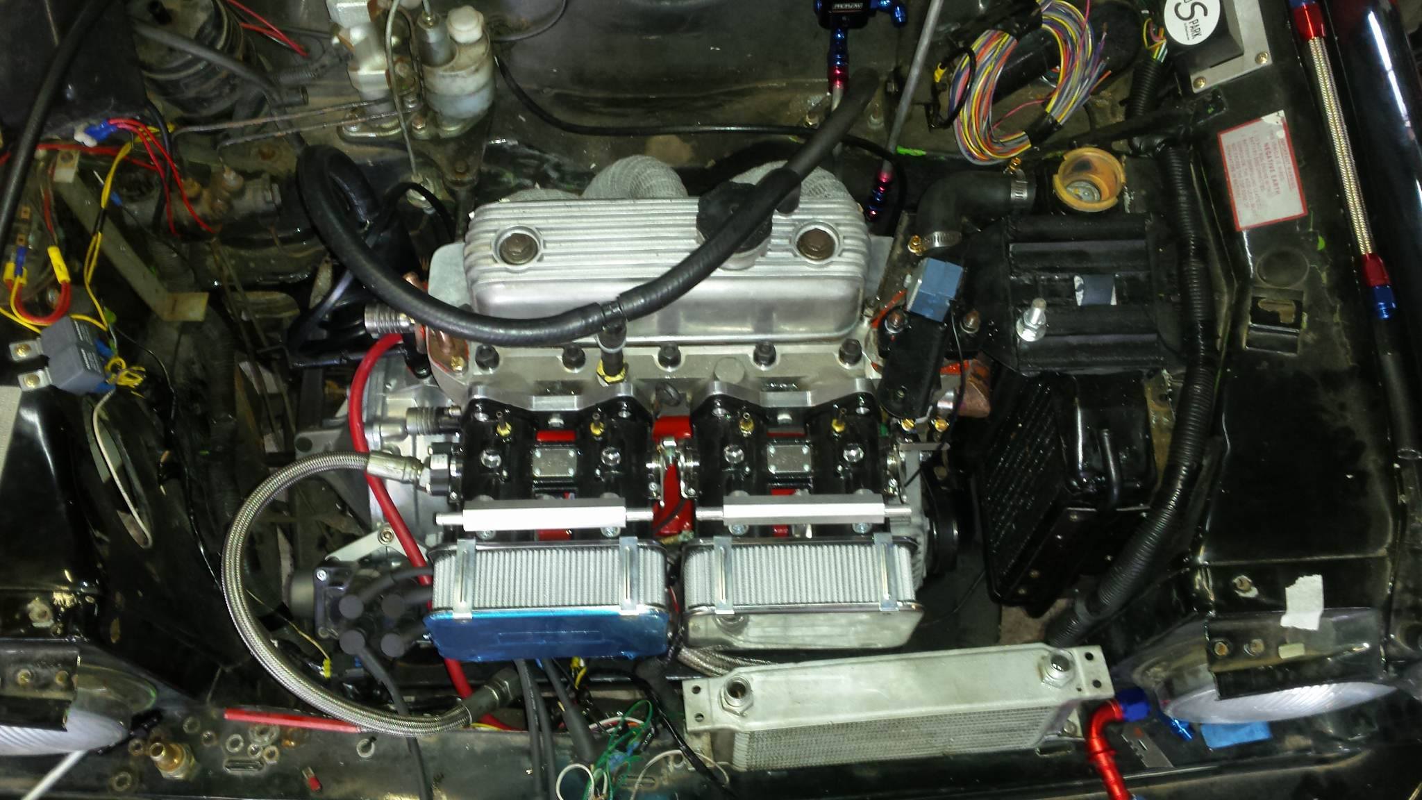

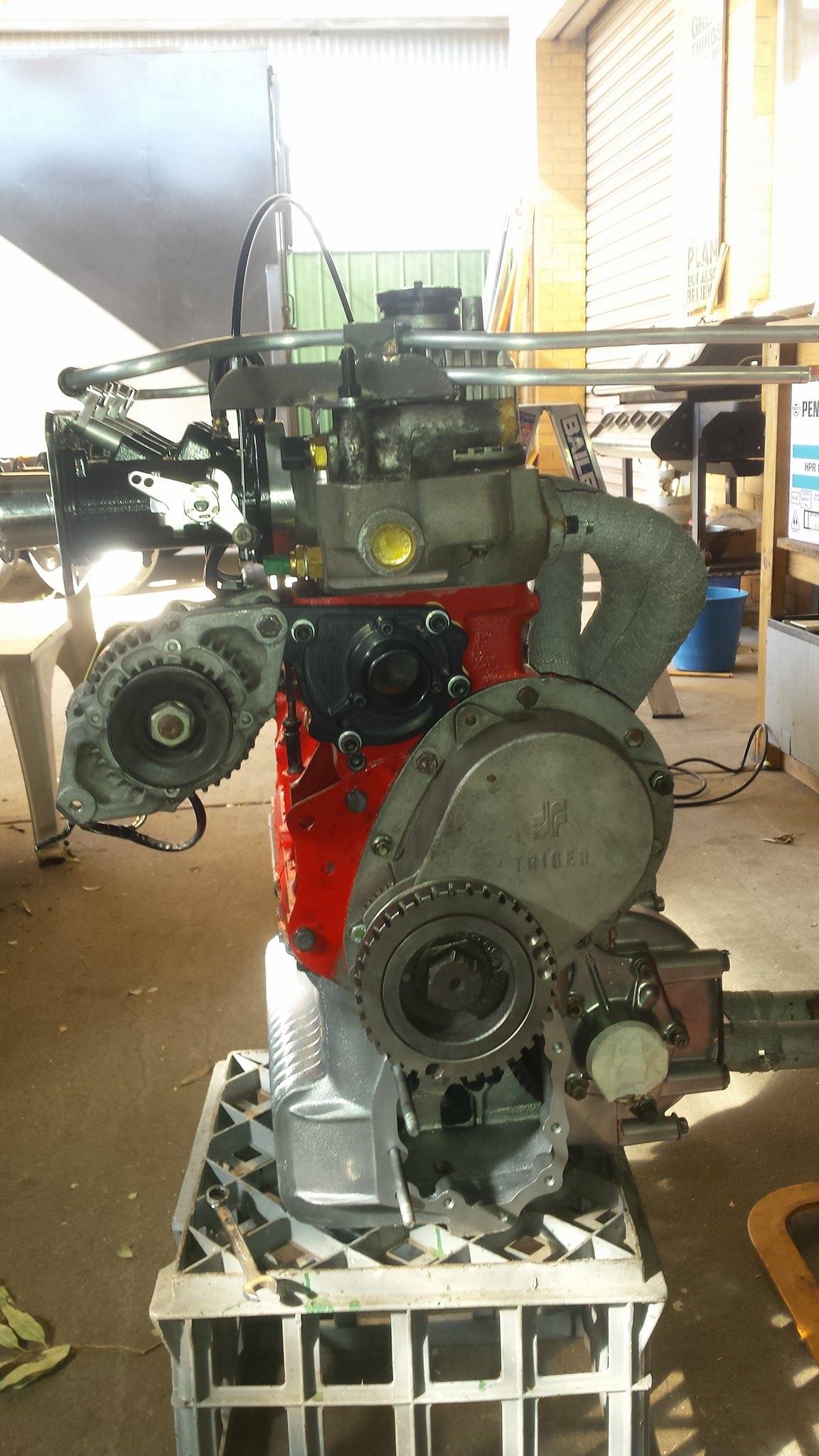

Well ... what a full on day yesterday was. My mate who was in charge of the sparks was flat out from 12 till 11:30 pm so I wore him out :)
We have 75 psi oil pressure, which on running in oil is a tad too high but I can wind that back a bit with the adjustable relief valve.
Engine bay has had a new fuse box and a general tidy up of under bonnet wiring, fuel system had a few leaks but sorted now. My rad cracked the bottom hose outlet so I'l have to rejig the " new " rad mounts to hold another rad and then that will also mean the throttle linkage will need to be remade ...more shed time :)
I have a mystery oil leak down the front of the engine but with the rad out that should be easy to spot and hopefully fix.
The thermo fan and ewp80 works well, the controller gives my outside temp and engine temp + runs for 3 mins after shut down. After running in the cam it was sitting at 92 deg and with the pump / fan running after shutdown the temp dropped to 77 deg so I call that a win.

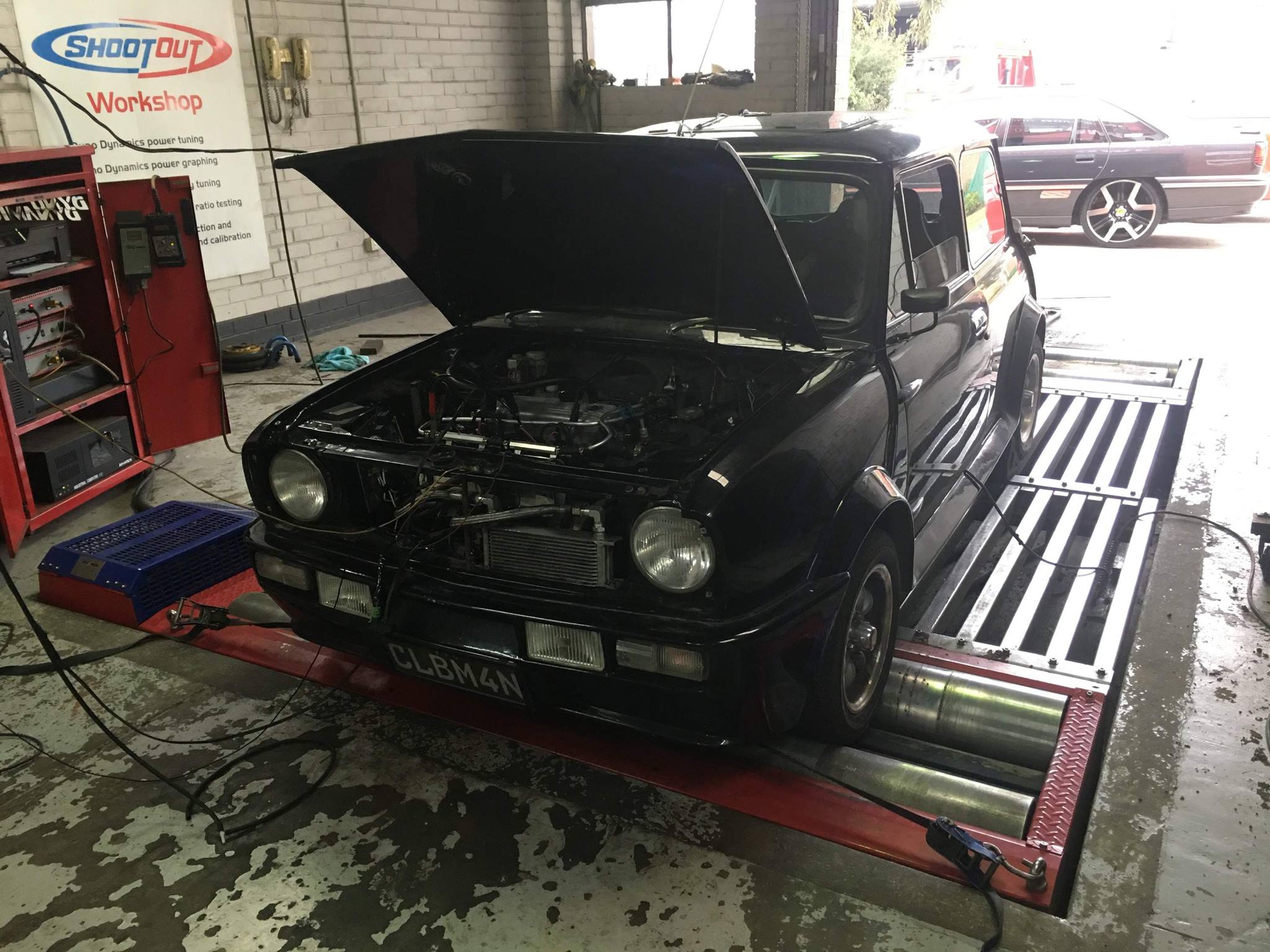

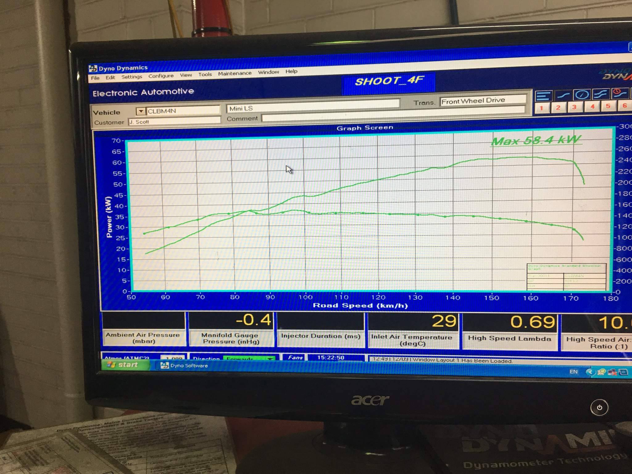

Dropped it off at the tuners on Sat and it get it's dyno runs tomorrow ......I will either get a phone call to say " bring a trailer coz it flew apart " or come get it bring cash or and here's the "sheet" for pub bragging rights.
Currently suffering through separation anxiety.
1977 Leyland mini Sunshine -- moleseted -- Named " Ray" becoming a 7 port efi slowly
1971 Nota Fang 145 bhp 5 port fun @ 450 kg
1969 Austin 1800 ute, 1800S running gear, tip rat and hardware store runner
clbm4n
62 Posts
Member #: 11458
Melbourne Australia ... not a convict
Just got off the phone with my tuner dude *smiley*
Other than my bonkers way of running the idle control valve he says " for it's size it's pretty good" { he mainly does v8's and race cars and big turbo jobbies }
I'll let the " pub bragging sheet" do the talking while I nick back to the fridge and find another beer.
