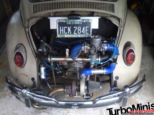

Done. I need a close up really

Is that blue elbow on the vacuum side of the carb a rigid pipe or a soft hose? what about the two black elbows on the plenums?
because if they are they'll probably suck flatter than a witches tit.
I do think it needs a real plenum once you get the fueling right.
also we need close ups so we can actuially see whats going on.

Hi Sprocket. The 90 degree black elbows are fairly rigid, The blue 90 in front of the carb is softer and with vacuum is it goes suck in on itself. I am going to fix this once I get the fuel working. Good spot.
