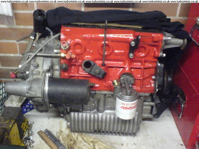

A bit more progress-

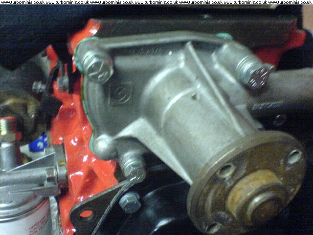

Also found out I have a rogue waterpump. Its been a while since I have built a mini engine so when I bolted the water pump on I scratched my head for a bit trying to figure where the alternator mounted......only to realise the pump should have a lug cast in....
God knows what this pump is off, its brand new but I can't remember where the hell I got it from. If its any good to anyone then let me know and you can have it.
I have also found that I am missing the lower radiator mounting bracket.
Bolts on here-
Does anyone have one I can beg/buy?
Dangerous
2521 Posts
Member #: 417
could be a mpi pump,as the alternator bolts to the head on them
You could well be right there, will have to have a look next time I am under the bonnet of an MPi.
That's a pump off an 'in-line' a-series i'm sure... That looks like a 'leyland' logo on it? unlikely to be MPi!
Note there is no (by-pass) pipe going up to the head either... Even metros had the lump for the pipe there - it just wasn't drilled out.

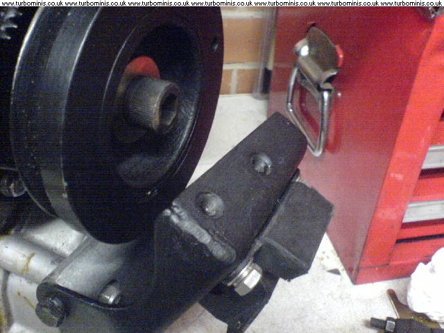

Don't forget to leave the long bolts loose - the ones holding the fabricated steel engine mount to the gearbox. Makes it so much easier to settle the engine in the frame and line up the engine mount holes.
Virtually every time folks have troubles, is becuase they've fitted this bracket, pulling it away from the bottom pulley, then tioghtening the bolts really hard - result; it doesn't seat into the subframe!
I did think it might be a pump from an 'inline' engine such as a Midget etc, but then surely those would also need the lug for mounting the alternator in the same way as on a mini?
Iain, let me know about those bits, could run over one night and pick them up from you?
Wil, cheers for the offer, will let you know if Iain can't find one.
