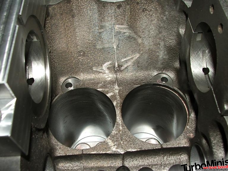

I have short liners *tongue* So if anything you are in breach of my trade mark *laughing*
I instructed my machinist to makesure the liners sat on a ledge at the bottom of the bore, as a gaurantee that they wont fall out the bottom at 9000rpm *wink*
You can see it here
As for cracking, who, if any one has seen a dry liner cracked?
