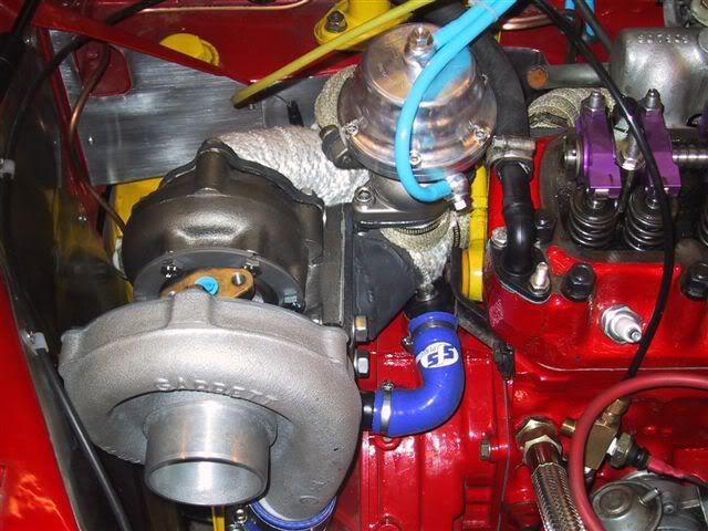

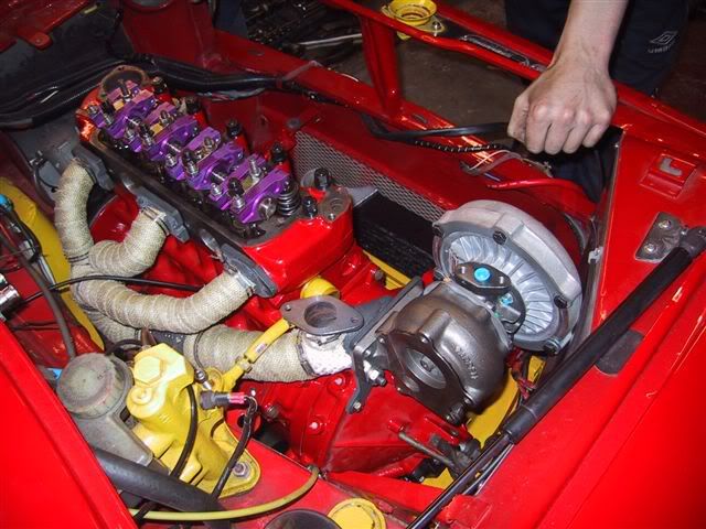

Are there any more folks out there with this type of install?
turboestate
368 Posts
Member #: 362
durham area
Hi the red clubman is mine the exhaust manifold is a choped up lcb wich lately has been playing up (cracking) ive purchased some 304 stainles now and doing it again the pipe size ive used is 38.1mm outside 2.64mm wall thickness the bellows are 51mm inside as is the pipe to the turbo, in the beggining the turbo was a t3/t4 hybrid but was found to be tooooo big its now a overhauled standard t3 with a .25 exhaust housing cant see any detrimental efect of putting the turbo there in my eyes it was wasted space and i wanted something differentstill comes on boost at 1750-2000 rpm and throughs you in your seat on 10 PSI that olone makes all ok LOL
http://i18.photobucket.com/albums/b122/tur...stegatePipe.jpg
http://i18.photobucket.com/albums/b122/tur...teInstalled.jpg
http://i18.photobucket.com/albums/b122/tur...heenginebay.jpg
